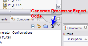

I have two FRDM-KL25 boards, I installed CW 10.3 and The Kinetis L sample code.  Using the instructions in the FRDM-KL25Z-QSP document I compiled and ran the hello-world application without incident.  When I try the other samples in the same folder they all fail with errors like:

KL25_sc provides CW examples using Processor Expert (PEx) tool, one of this examples is accelerometer_demo which is in projects folder. PEx projects needs to generate the code for each component. That is why CW compiler does not find some UART functions or others.
You need to Generate Processor Expert Code:
  1. Click on Generate Processor Expert Code button.
   2.  Wait......
   3.  Compile again.
Hope this helps.

I needed the Community Development License for PE to work, once I found
that all is well.
