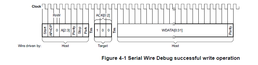

SWD: The ARM Serial Wire Debug interface uses a single bidirectional data connection(SWDIO) and a separate clock (SWDCLK) to transfer data synchronously. An operation on the wire consists of two or three phases:
Packet request       The external host debugger issues a request to the DP. The DP is the target of the request.
Acknowledge response   The target sends an acknowledge response to the host.
Data transfer phase
First enter into SWD mode: Send at least 50 SWCLKTCK cycles with SWDIOTMS HIGH and 0xE79E. This ensures that the current interface is in its reset state and enable the SWD mode.

Then write DP/AP register. A successful write operation is as below:
