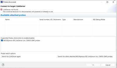

I have a KW38-ER-RD board and have problem flashing a code into it during the "debug" procedure of "IDE".  The snapshot of the error is attached here.
This happened after I loaded a BLE code into it which I assume it has put the device in sleep mode. I however, has tried pushing the SW3 a few times to wake it up, but it was not successful. Any suggestion?

Hello @ArianRF,
Could you please help us with a picture of your board? Also, which BLE project did you load into your device?
If this is your own design, more information about this board would be very helpful.

I successfully downloaded the SDK for KW38-ER-RD and tried to load the "Hello world" example but it still gives me the same error:
I also checked the Device Manager. It shows USB Serial Device (COM7):
I am not clear about the external debugger. I am using the IDE (MCUExpresso). I think loading the "frdmkw38_beacon_freertos" has put the device in low power and the open SDA is not working properly. I have tried to reset the SW3 but still not successful. This happened another time with FRDM-KW38 board and  Eduardo ( @EduardoZamora ) helped me on this. I was able to make it up and running after a few pressing of SW3. However this time, for KW38-ER-RD I can't get it work.

Could you please try pressing repeatedly SW2 while target discovery is running?
Just to confirm, does your debug probe implement J-Link firmware or is it CMSIS-DAP firmware?

I am not sure but I think it is CMSIS-DAP. How can I find out?
This is the snapshot I took while loading the "hello world" from SDK:
I have tried pressing SW2 while clicked on "debug" button on IDE, still it gives me same error.

Could you please try updating to the latest OpenSDA version available for this device following the procedure shown in this article? Please, try with the binary for the J-Link version.

After a few attempts of several openSDA files , "46_OpenSDA_FRDM-KW36.bin" worked well.
The "53_OpenSDA_FRDM-KW38.bin" was not working when I drag and dropped it. However, after the successful drag and drop of "46_OpenSDA_FRDM-KW36.bin", I was able to drag and drop  "53_OpenSDA_FRDM-KW38.bin". However, here I face a couple of new errors.
1st, the windows does not recognize the board anymore:
2nd, the IDE gives me a new error message:
Any idea?

Could you please confirm if you can access/debug the KW38 by using an external debugger (through SWD connector)? Example of this external debugger is the MCU-Link Pro Debug Probe and SWD connector for the KW38 should be J1.

Please, consider using an external debug probe just to verify that KW38 chipset is still working.
