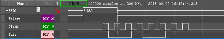

In a project based on KEAZ128 , the PE  component  "SPIMaster_Ldd"  was used .
The  slave select signals were configured as GPIO . But the CS output is wrong  as shown in the following picture:
SPI CLOCK=500KHz

Why the CS single   goes HIGH before the clock?

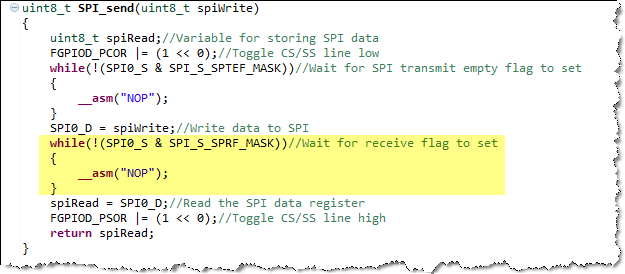

Robin_Shen
The key point in that document is to check the SPRF flag.
Only this flat is able to indicate the shift register is received in(sent out) done.

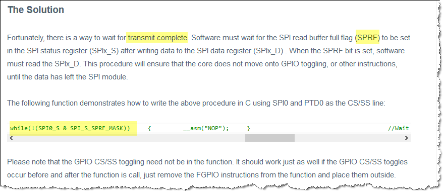

kigerzhang
Dear Robin,
Thank you so much for your support.
I checked the document  (  L-Series SPI GPIO CS/SS.) that you pointed to .
The key point in that document is to check the  SPTEF  flag .
I  digged into the function "SM1_GetBlockSentStatus"  of  SPIMaster_Ldd ,it does  the same thing.

In fact the root cause is : the data in the TX buffer is moved to shift register so fast , but the data in the shift register should be sent out to the pin based on the  SCK .
In page 534 of KEA128RM , the STPEF  description:
SPTEF is automatically set when all data from the transmit buffer transfers into the transmit shift register. For an idle  SPI, data written to D is transferred to the shifter almost immediately so that SPTEF is set within two bus cycles, allowing a second set of data to be queued into the transmit buffer. After completion of the transfer
of the data in the shift register, the queued data from the transmit buffer automatically moves to the shifter,
and SPTEF is set to indicate that room exists for new data in the transmit buffer. ..."
So ,what I want to know is : whether is there a flat to indicate that the shift register is sent out done, at that time the CS pin can be toggled.

Robin_Shen
