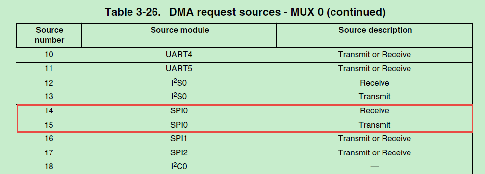

There is code in the open source uTasker project.
This is the extract from the developer's version (more advanced and supported). Eg. for any UART (channel is 0..5)
fnConfigDMA_buffer(UART_DMA_RX_CHANNEL[channel], (DMAMUX_CHCFG_SOURCE_UART0_RX + (2 * channel)), buffer_length, uart_data_reg, (void *)buffer_address, (DMA_DIRECTION_INPUT | DMA_BYTES), 0, 0);
so for SPI slave uart_data_reg is replaced by the SPI rx reg address  and DMAMUX_CHCFG_SOURCE_UART0_RX by DMAMUX_CHCFG_SOURCE_SPI0_RX.If the SPI is not in 8 bit mode DMA_HALF_WORDS or DMA_LONG_WORDS is defined to suit (instead of DMA_BYTES).
fnConfigDMA_buffer() works for all DMA controller types (compatible on all K or KL parts with DMA) and free-running mode is set when no full-buffer interrupt or half-buffer-interupt is defined (last parameter 0).
Complete routine follows so you can pick out the bits of interest.

Hui_Ma
The DSPI_SlaveTransferEDMA() function with below description:
The K64 chip SPI modules, only SPI0 module provide split RX/TX DMA request.
Please check if you are using SPI0 module as SPI slave.
And how do you set the TRANSFER_SIZE value, if you want to get more than 512 bytes SPI data, the TRANSFER_SIZE should be more than 512.
Wish it helps.
Mike

unknowncoder
Thanks for the post. But this is not what I am asking.
  • I am using SPI0 so I can get separate DMA request.
  • I am only receiving data from the master. So I am not doing any transmitting.
  • The EDMA support circular buffer mode by setting up the ATTR register.
  • I have setup the DMA in circular buffer mode then when I call DSPI_SlaveTransferEDMA() it erase the ATTR register, because the call to DSPI_SlaveTransferEDMA() is also calling EDMA_SetTransferConfig(). When EDMA_SetTransferConfig() calls it complete erase the ATTR register.
  • Also when EDMA_DspiSlaveCallback() callback is called by the DMA it stops the DMA from running by calling DSPI_DisableDMA() this is another reason why the DMA can't be placed in circular buffer mode with the SPI driver.
  • It looks like the SPI_DMA driver does not support using the DMA in circular buffer mode. From the looks of it it seems I will need to write a custom SPI_DMA driver to use the DMA in circular buffer modem, because at the throughput I am running I could miss data if I don't leave the DMA running.
If anyone else has use the SPI_DMA driver in circular mode sharing the code would be greatly apperciated.
