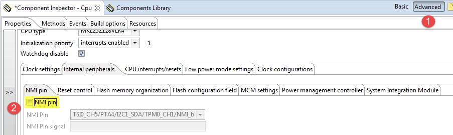

Jorge_Gonzalez
Hello Aline:
Try removing the resistor on PTA4. It is important because that pin is the NMI (non-maskable interrupt) and if grounded then the interrupt will fire. If not attended and cleared then it will hold any other interrupts and most probably continuously trigger.
You can also disable the pin with Processor Expert, just enable the "Advanced" settings:
Regards!
Jorge Gonzalez
