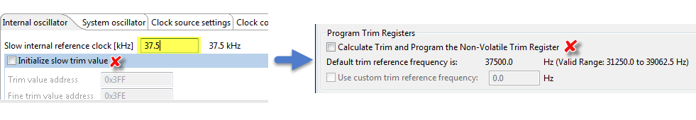

Jorge_Gonzalez
Hello umsankar kalluru:
Jennie is correct, most probably the cause is the internal clock trimming. By default the KE04 is factory trimmed to 37.5 kHz. I think you are using Processor Expert, so please consider these 2 scenarios:
Case 1)
If using the factory trimmed values, make sure Processor Expert uses the 37.5 kHz frequency, disable the "Initialize slow trim value" and disable the "Calculate Trim..." option from the debug configuration:
Case 2)
For a different internal frequency (e.g. 31.25 kHz), set the frequency to Processor Expert, enable the "Initialize slow trim value", enable the "Calculate Trim..." option and also the "Use custom trim..." option with the desired frequency in the debug configuration:
Regards!
Jorge Gonzalez
2,870 Views
umsankarkalluru
I am not able to find the "Program Trim Register" window in debug configuration.
We are using KDS 2.00 and Segger J link for debugging,
2,870 Views
Jorge_Gonzalez
Hello:
Segger J link does not have the option to trim the internal reference, only P&E connections. In your case go with case (1) mentioned in my reply above.
Regards!
Jorge Gonzalez
