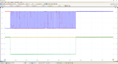

We see that the last bit in every Byte transmission on MOSI is set to high. We are using the SPI with DMA
If I read the registers of the SPI after the configuration I get:
- MCR   0x883F0000
- TCR    0x00000000
- CTAR  0x3E050004
- CTAR  0x78000000
- SR       0x42000000
If we connect the oscilloscope to the SPI lines we see the next:
Blue -> SCK
Red -> MOSI
Green -> /CS
Yellow -> /RESET (device reset)

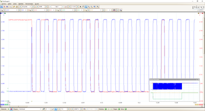

If we zoom on the MOSI and SCK lines we see the issue. This 2 bytes that can be seen in the capture are 0x52 and 0x00. You can see how the last bit goes high in both bytes.
Does anyone know why this could be happening?

We have tested with the MOSI line disconnected in the ADC and the we see the same behaviour.
We are able to communicate with the ADC the most of the times, but there are other times that the data we receive from it does not make sense.
Thanks for you help.

Thanks for all your help, but It seems that the error with the ADC is not related to the SPI communication. We thought that as we saw that extrange behaviour on the SPI.
