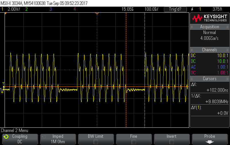

Working on optimizing transfer rates to s SPI flash I have observed quite large inter byte/word delay on the SPI bus.
My system is running 120 MHz system clock and 30 MHz SPI clock, and i am using the standard fsl_dspi_edma driver.
When transmitting multiples bytes via DMA, i see that the transfer of the each 8 data bits take about 266ns as expected, but between bytes i see a delay of  ~100 ns.   Transfer is done with kDSPI_MasterPcsContinuous set.
I was initially using SPI1, and as i was suspecting the delay being related to the missing FIFO on this channel i moved to SPI0 that has 4 level FIFO.  However i see the same timing the channel.
Are there any ways to control interword timing on SPI transfers or is the interbyte delay expected behaviour?

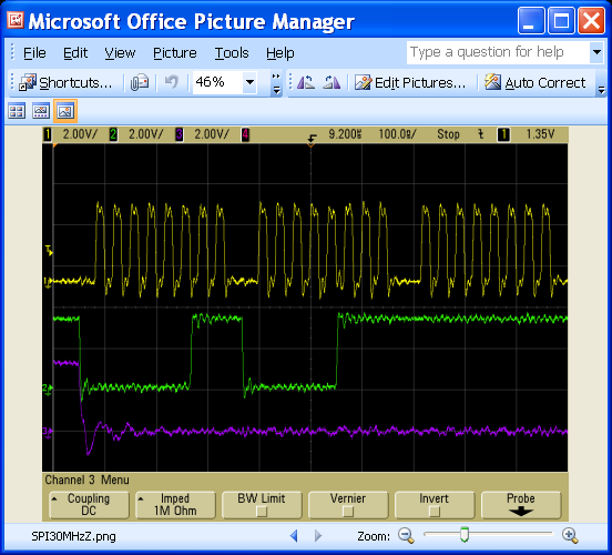

'For better or worse' Tpcssck, Tpasc, and Tdt apply between transfers, whether there are CS edges or not.
That being said, I have been unable to squeeze out '1.5 clocks' of internal transfer delay either.  I show an extra 50ns below (317ns/byte, rather than 'ideal' 267).
BTW, I hope all that 'ringing' on your clock is due to poor scope grounding --- else you should be looking into some signal termination!

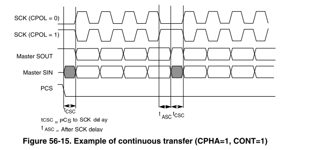

From the formulas in the reference manual i would expect something like this
System clock 120 MHz -  Bus Clock 60 Mhz
PCSSCK=0, CSSCk=0 --> tcsc=(1/60M)*1*2=33,3ns
PASS=0, ASC=0, tasc=(1/60M)*1*2=33,3ns
PDT=0, DT=0, tdt=(1/60M)*1*2=33,3ns
Whith continous PCS only tasc and tcsc components should be in effect, resulting in 66,7ns
However with these settings I stil get ~100ns gaps.
