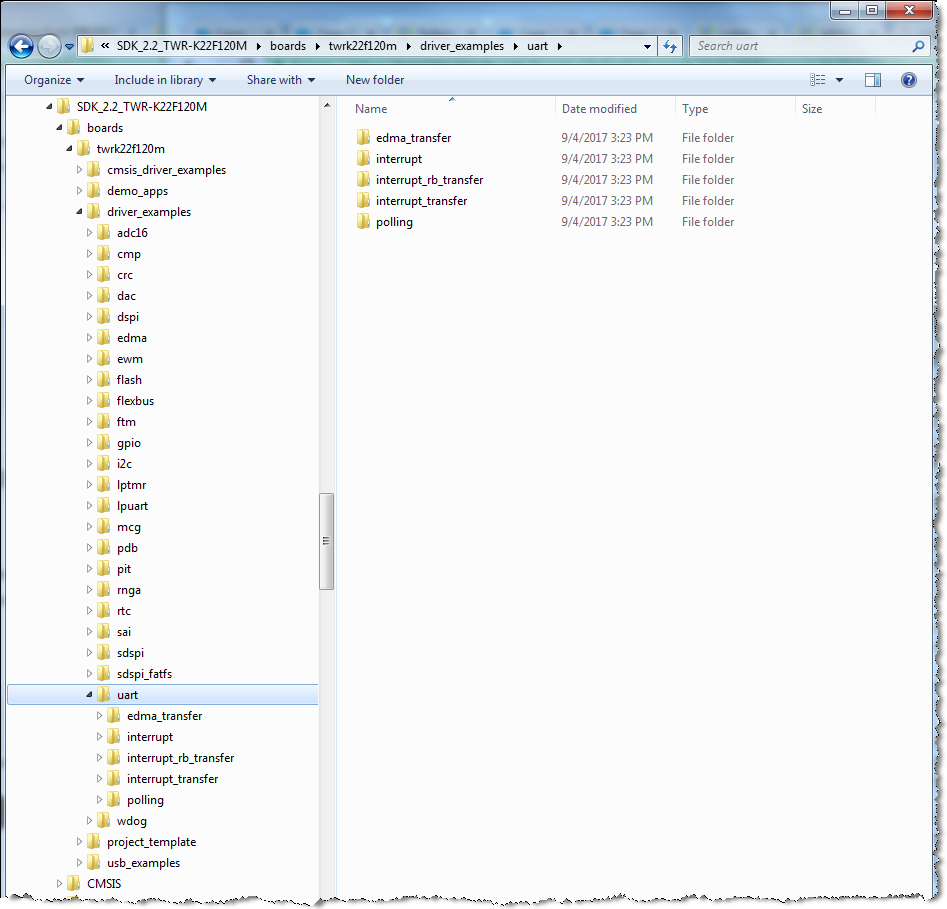

I'm using a MK22F51212 chip on a custom circuit board. The UART0 line is hooked up to a ORG1411 GPS and I'm trying to read NMEA strings out of the device and into a buffer.
I am following the demo project in the KSDK 2.0 driver_examples/uart/polling to initialize and read the UART data.
I am able to read the 8 bytes out of the buffer. This is the first 8 bytes sent by the GPS which I have confirmed is accurate based on the GPS data sheet. After that every read I make I only read 0's, this happens whether I'm reading a byte at a time or a whole 8 byte buffer.
Is there another step I need to do after a read? I'm using the UART_ReadBlocking function.

Hey Robin,
Thanks for the suggestion! Looks like we are going to try to implement the edma interrupt method with a ring buffer. The polling must be causing some kind of overflow because we aren't reading fast enough. I'll let you know if this works.

Hi Brendan,
Would you please send the project to me so that I can test your project on FRDM-K22F or TWR-K22F120M board. And please send one frame data in hex from GPS.
The UART0 of K22F120M contains 8-entry transmit and 8-entry receive FIFOs, this helps to reduce the load of the core.
For example:
    config.rxFifoWatermark = 8;
    config.txFifoWatermark = 8;
    UART_ReadBlocking(DEMO_UART, &ch, 8);
    UART_WriteBlocking(DEMO_UART, &ch, 8);
Normally we will not use the polling example, maybe you can test these examples with interrupt.
