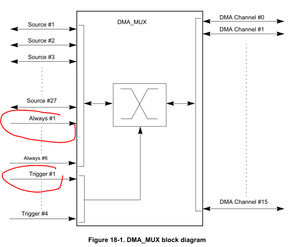

1. Want to send 5 SPI commands for 20 times with PIT configuration.
2. Configure PIT0 for time x and PIT1 for 20 * x and send first 5 SPI commands in DMA and retrigger the same set of commands for 20 times.
3. Once 20 iterations completed, PIT1 must trigger interrupt and disable PIT
4. This I am trying to achieve without software intervention, the software intervenation will be after 20 iteration to service the interrupt.
5. I am not able to achieve this with MPC56, How can achieve this? Is there any dependency
6. The PIT0 is not triggering DMA after first transfer, configured the registers in DMA_MUX, Once the PIT0 triggers DMA data transfer, do we need software intervantion or it is possible to send data transfer without software intervation?

yes, this can be achieved.
Use "Always enabled" together with PIT Trigger.
Configure the descriptor for Always Enabled channel in a way that it starts 5 SPI transfers - you can write to DMASERQ register to enable DMA channel which sends data to SPI. You should set d_req (disable request) bit to disable DMA channel after 5 bytes.
You can enable interrupt (int_maj bit) in descriptor for Always Enabled channel, so you will get an interrupt when last 5-byte SPI transfer is triggered.
