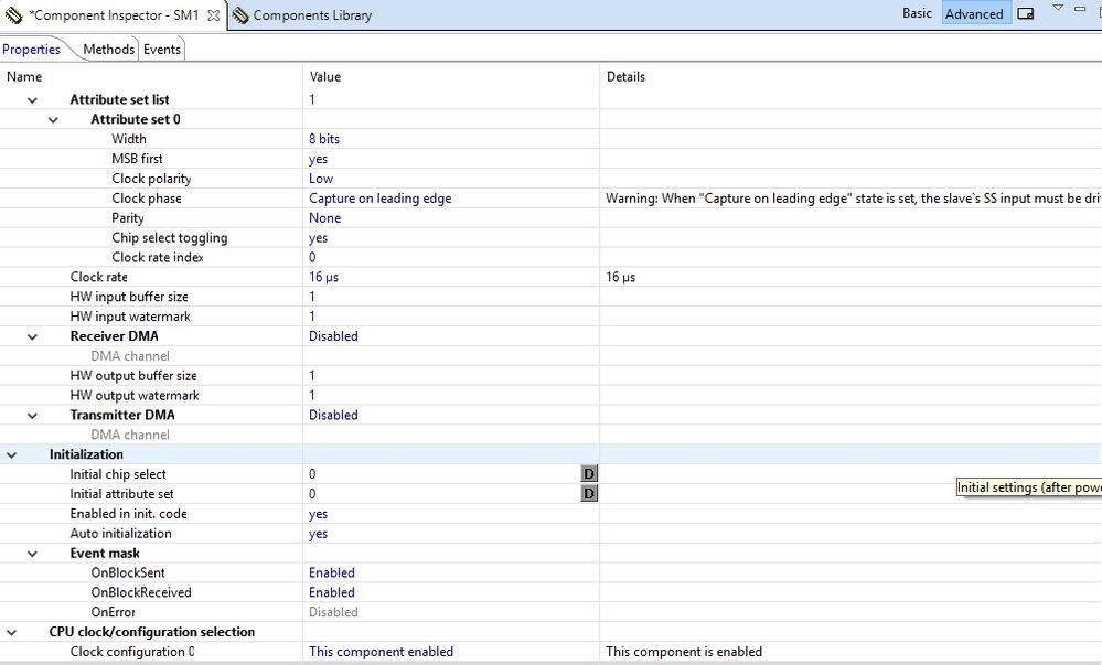

I can not get communication with TLE7242 (4 Channel Fixed Frequency Constant Current Control IC)
I was trying using interrupt as well polling methods,
PWMSPIPtr = SM1_Init(NULL);
RESET_OUT_ClrVal();  // Toggle Reset TLE7242
 status.SM1_SendFlag = TRUE;
 RESET_OUT_SetVal();
 ENABLE_SetVal();
for(;;)
Error = SM1_ReceiveBlock(PWMSPIPtr, SPIData.InpBuffer, SPI_SIZE); /* Request data block reception */
Error = SM1_SendBlock(PWMSPIPtr, SPIData.OutBuffer, SPI_SIZE); /* Start transmission/reception */
 while (!SM1_GetBlockReceivedStatus(PWMSPIPtr))
 { /* Wait until data block is transmitted/received */
  SM1_Main(PWMSPIPtr);

Hi Kerry,
I am using LTC2634 DAC in MSOP package, which has only SDI input, however it is using SPI MOSI only for data transfer should be enough. Accordance to Datasheet, I have selected Clock phase "Capture on leading edge", means shift clock edge on "falling edge" set. However, I must toggle Chip select in PEx, which transmission "byte by byte" seems be accepted but demo_spi clock setup is different. DAC can read single data here but is getting confused when changing channel number. Looks I can not use SPI for this DAC, seems need change to relevant I2C DAC.

Hi Marceli,
   I am not familiar with your LTC2634 chip, but if you want to use the SPI, because that chip have the CS control flow, so I suggest you don't use the SPI_CS pin function directly in the KL25, but use the GPIO to control it, then it won't be toggle CS pin byte by byte. Just use the GPIO code to control the CS pin, this method won't have the byte by byte CS toggle problem.

kerryzhou
Hi Marceli Firlej,
   Do have checked the SPI bus wave on your side?
   I suggest you use the GPIO to control the SPI_CS, instead of the SPI hardware CS function.
  Because as I know, some external SPI slave need the special CS control flow, you need to check your TLE7242 datasheet, just make sure your SPI send out the wave meet your external SPI slave chip's demand.
