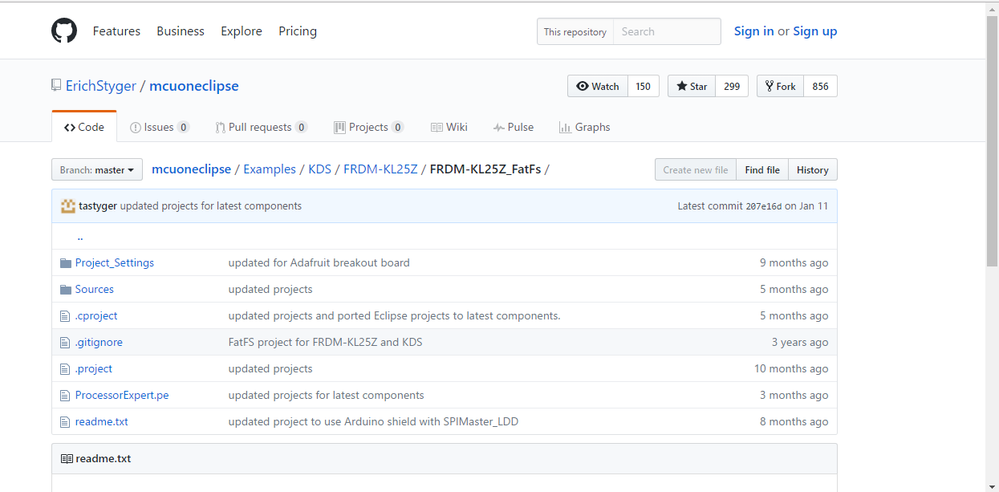

arthshah
7,535 Views
arthshah
Here i attached screen shot of github project file list.
from t hat which file i open?
when i opened any file its show html file.
how can i use your project in my KDS?
thank you in advance.
7,538 Views
