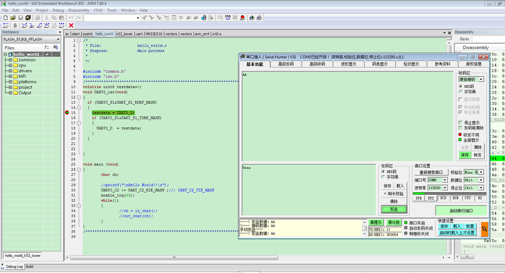

     I try to interface fingerprint module with k53.when i send commands to the module and try to read back from the data register.i couldnot get anything when i put the condition for receive read flag(RDRF)in status its not all satisfying the condition.Can anyone say the uart interrupt for both receive and send clearly.thank in advance

   Did you use the CommAssistant tool to test your fingerprint before? For example hypertrm.
   You must make sure your fingerprint can work at first.
   About the uart interrupt for receive and send.
   Actually, after you initialize the TIE and RIE in the UARTx_C2, and enable the according IRQ, add the ISR function. You can get the according interrupt work.
  Take TWR-K53N512 board sample code as an example.
  After enable the RIE, when the UART receive the UART data, it will enter the UART0_isr interrupt. Then send the received data back.
  I have attached my test code for your reference. The baud rate is 115200. Test board is TWR-K53N512.
Wish it helps you!
Kerry

Thank you Kerry for the reply.Initially i have tested fingerprint module using sfgdemo software just taking 2 finger prints so i am sure about module working.But ,when i try in real term like sending  commands from real term send as numbers it does not transmit.So,can you say about how to test in realterm whether my commands are transmitting or not.Even if i send commands my module is not responding i.e led in module is not blinking.Thanks in advance.

   From your document, we can see that when K53 send data, your realTerm can receive it.
   Now, your problem is when use real term send data, you don't know whether it is really send.
   Actually, many ways can check it.
1. Loop back.
   real term is the PC software, you can connect TX and RX together in your COM-USB tool which connect to the PC, then check, when realTerm send data, whether itself can receive it or not.
2. check wave with oscilloscope in the PC TX pin.
When realTerm send data, whether the oscilloscope can get the according UART data in the TX bus of PC, it also the RX bus for MCU.
Please check the send data at first.
Wish it helps you!
Kerry
