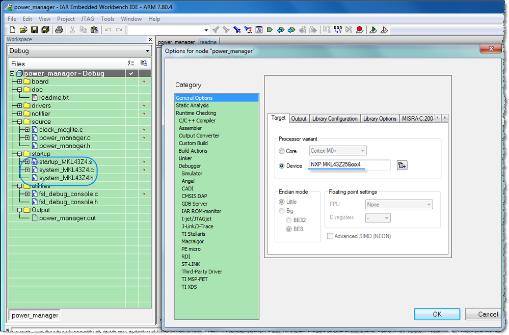

Have you try to test the power_manager demo_app in SDK_2.1_MKL17Z256xxx4?
You may need to modify the setting of that project in order to test on KL17.

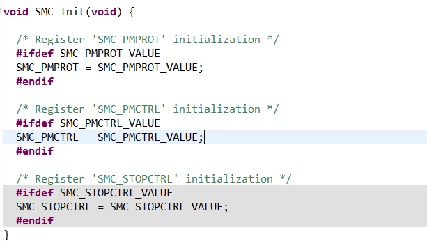

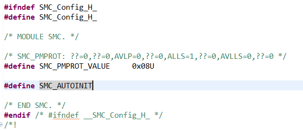

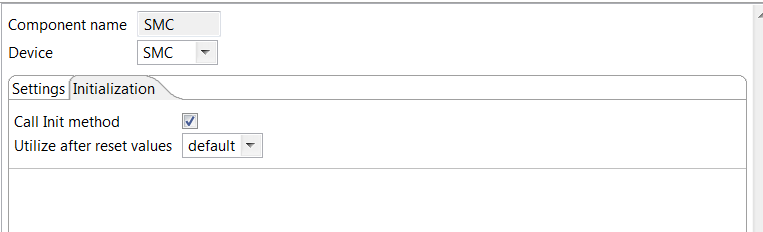

I don't really recognize the IDE or code you are using. I am using KSDK_1.3.0 with kinetis design studio.
Using processor expert I have these settings.
These settings generate this code.
And
After this the value of PMPROT still reads 0x0

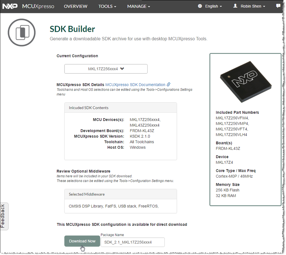

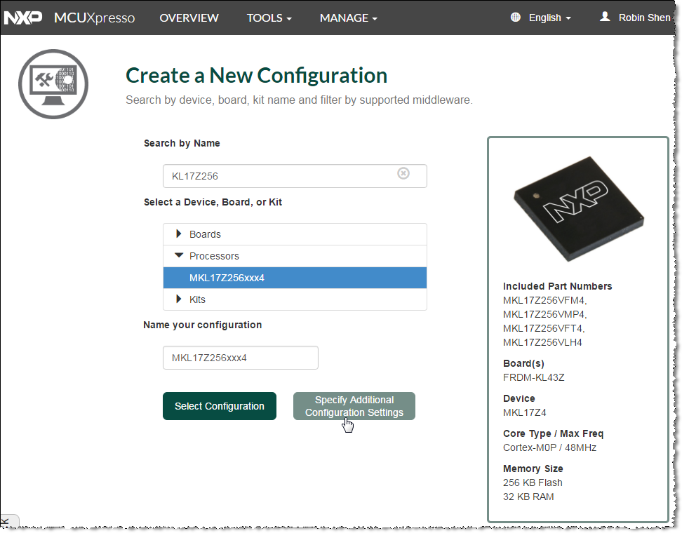

I recommand you using Kinetis SDK v2. You can download SDK_2.1_MKL17Z256xxx4 from here.

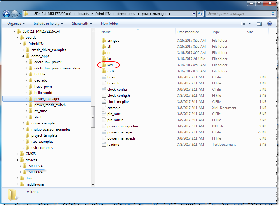

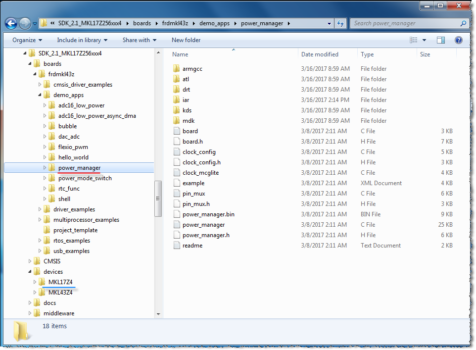

The power_manager project with Kinetis Design Studio can be found in below folder:
