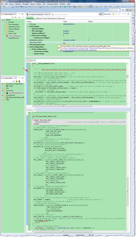

Hello.
Why i cant change the value on the sim copc?.
I know this register is one write every reset. i try to modified this value in __init__ hardware and this value doesn't change.
void __init_hardware()
SCB_VTOR = (uint32_t)__vector_table; /* Set the interrupt vector table position */
// Disable the Watchdog because it may reset the core before entering main().
//SIM_COPC = KINETIS_WDOG_DISABLED_CTRL;
SIM_COPC = 0x0C;

Hi Adrian,
I am not quite sure if you are using the code generated by Processor Expert.
Have you try to write your own code after select 'no' at 'Watchdog disable'? (For example: write your own code at line 301)
Or using the WatchDog_LDD component.
Robin

not sure what drivers you use but anyway usually during the start-up (based on e.g. DISABLE_WDOG macro definition in KSDK) there is a small piece of code which already write into the SIM_COPC register to disable WDOG in default. I user want to have enabled WDOG it is required to define macro in order to step over that piece of code during start-up. So, I assume that in your code it is already be written into the SIM_COPC before you trying to do so.
regards
R.
