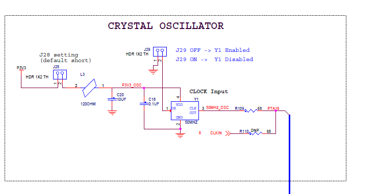

1) When I try the httpsrv demo and it does not work. I checked pin_mux, and looks like it is configured for MII0, not RMII0. I am using PE26 as reference input as well. Do you have any sample to work with this kind of configuration? or what do I need to change on existing project?

I am using PE26 as reference clock input. Could you tell me where I should set it?

I have checked that the PTE26 is multiplexed with ENET_1588_CLKIN, if you do not use 1588 protocol and just want to use Ethernet protocol, the ENET_1588_CLKIN clock is not required.

xiangjun_rong
Hi, Christie,
It is said that the you should use PHY clock source to drive EXTAL pin, the 50MHz PHY clock should be connected to PTA18, so on the TWR-KV58 board, you should populate the R110, remove the R109. Pls refer to schematics of the TWR-KV58.
