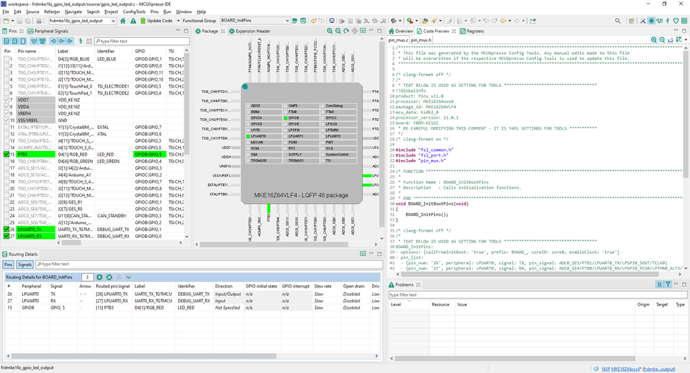

I am able to configure the Pins Tool after import frdmke16z_gpio_led_output example.

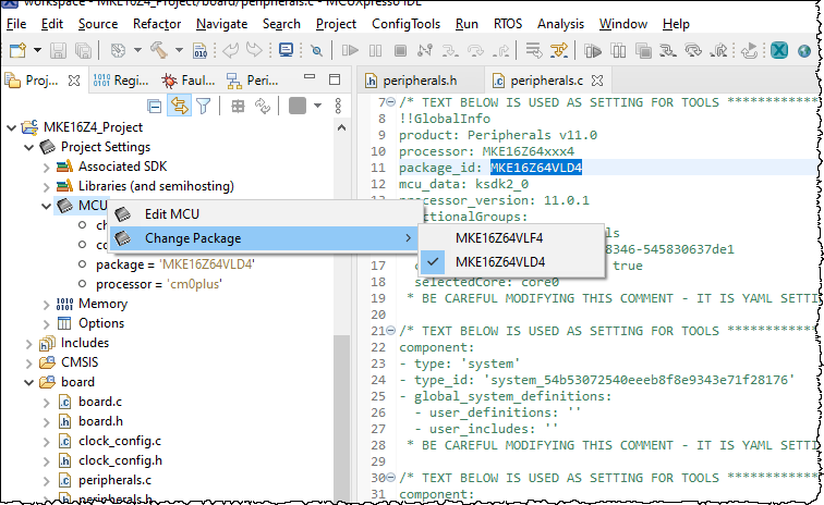

If you forget select MKE16Z64VLD4 during New Project, you can also Change Package here:
Change Package.pngChange Package.pngPins Tool MKE16Z64VLD4.pngPins Tool MKE16Z64VLD4.png

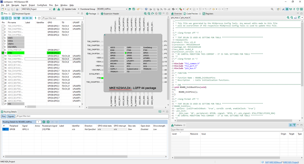

whiteliondd6
I configure in the same as you tried but, I got error:

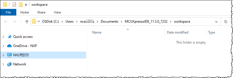

It seems to be caused by the different steps we do, please follow:
1. Please uninstall all the SDK and reinstall the SDK_2_11_0_MKE16Z64xxx4.
2. Exit MCUXpresso IDE and open again
3. Delete all the files in workspace(C:\Users\xxx\Documents\MCUXpressoIDE_11.5.0_7232\workspace)
4. Create a new project without select the FRDM board.
5. Select Device Packages MKE16Z64VLD4
