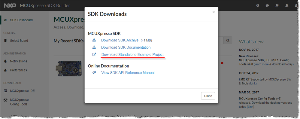

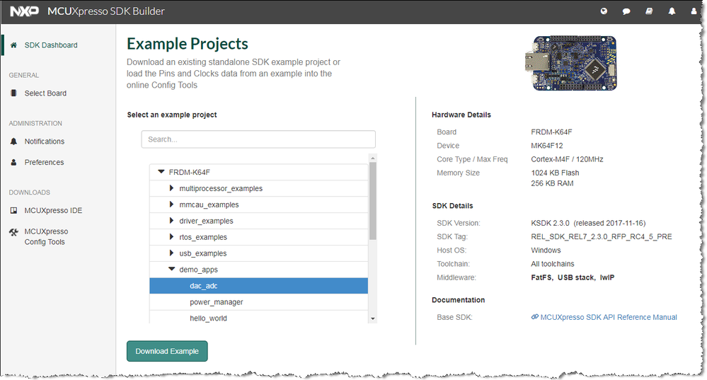

Robin_Shen
This Wizard may not used for SDK2.3.
Please try to download new project based on a demo during building SDK2.3.
Robin

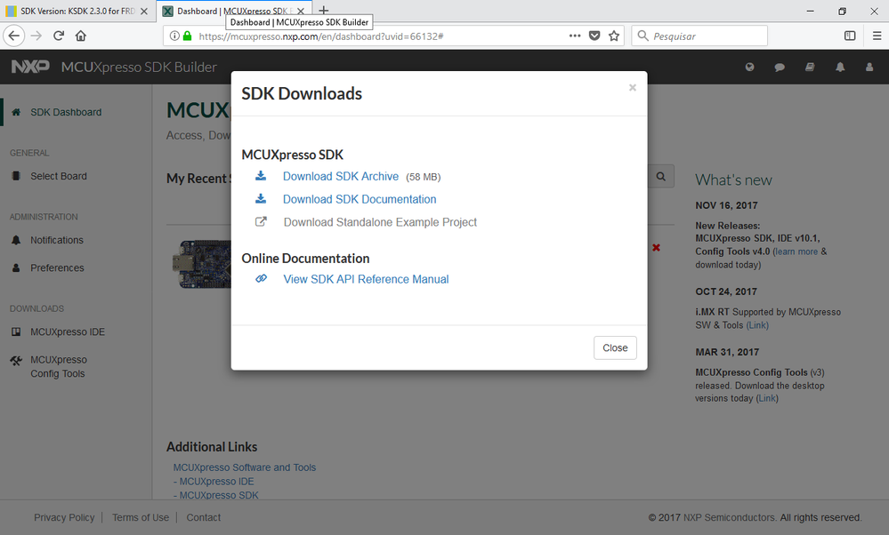

francismarsilva
The download is disabled for me...

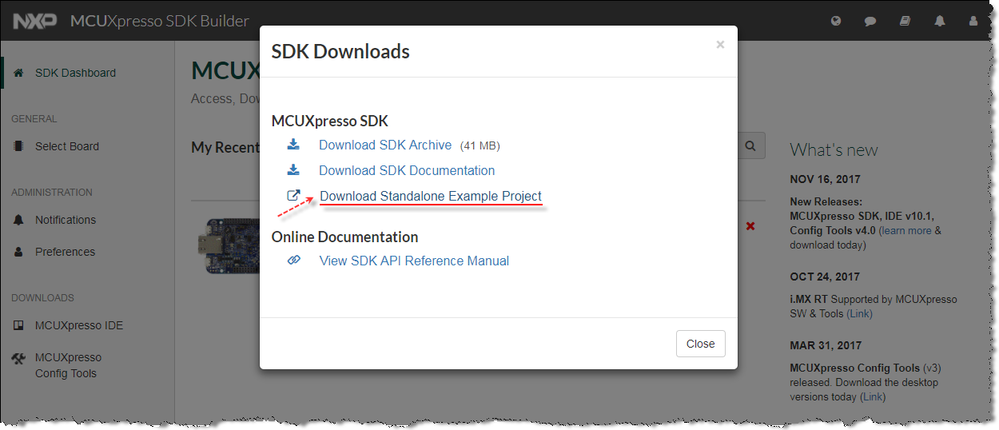

Robin_Shen
I follow three steps and can do that.
I don't know why your account can't download standalone example project.
Have you try to use a different browser or use new account?
Robin

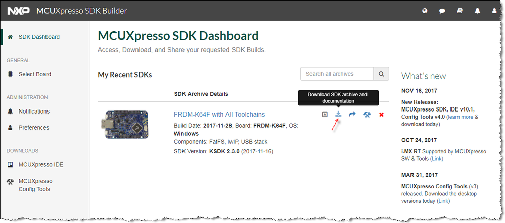

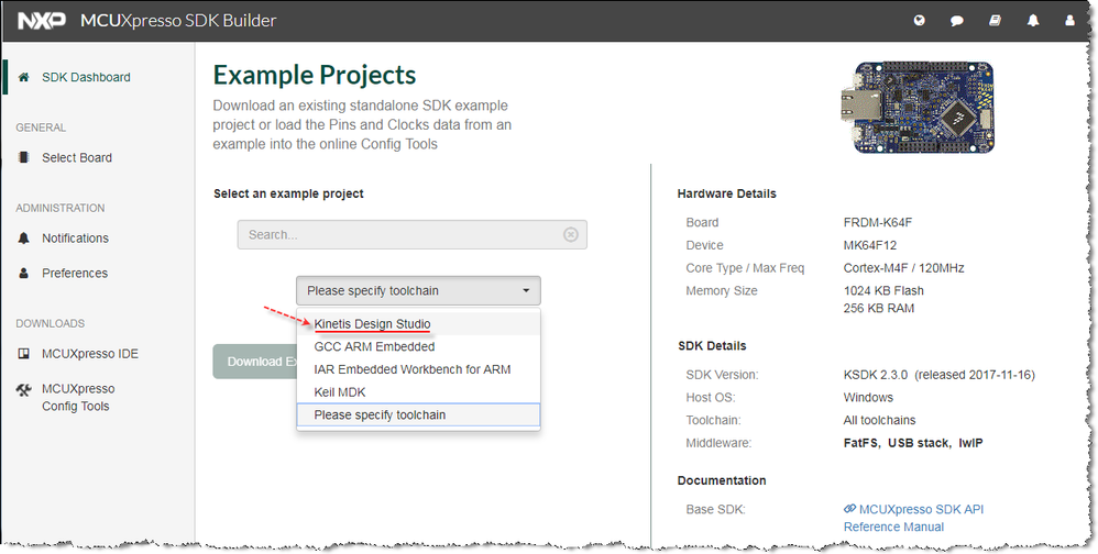

francismarsilva
When the package was created, I was choosing KDS only. When I chose "All Toolchains", as in yours, the option to download the demo was enabled.
