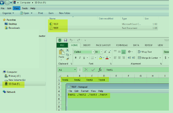

  This is the test result:
 Com print information:
SD card information:
Wish it helps you!

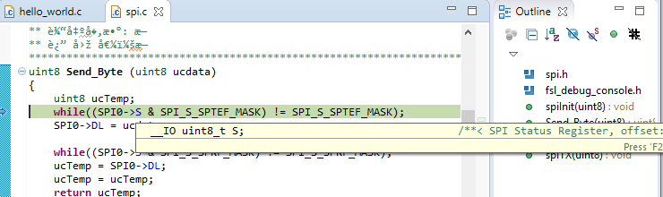

arthshah
hello kerry,
as we discuss this topic in message i have problem in spi_send or spi_init();
my execution stop in spi_send() function.
please help me for this.
thank you.

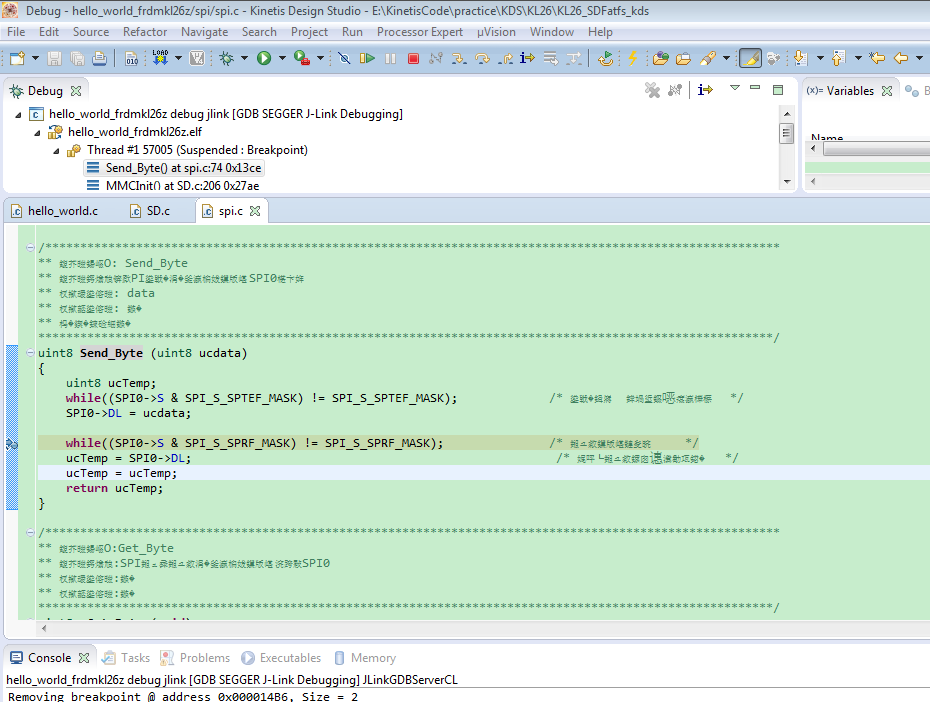

kerryzhou
Hi Arth Shah,
     Comment the Fatfs code, just leave MMCinit(),
    Main code like this:
int main(void)
    char ch;
    unsigned int i,j;
    FATFS fs;
    FRESULT fr;
    FIL            fil;
    UINT bw;
    char file_name1[12]="Test.csv";
    char file_name2[12]="Test.txt";
    /* Init board hardware. */
    BOARD_InitPins();
    BOARD_BootClockRUN();
    BOARD_InitDebugConsole();
    PRINTF("hello world.\r\n");
    spiInit(Master);
    MMCInit();
    fr= f_mount(&fs,file_name1,0);
    if(fr)
        PRINTF("\nError mounting file system\r\n");
        for(;;){}
    fr = f_open(&fil, file_name1, FA_WRITE | FA_OPEN_ALWAYS);//н¨csvÎļþ
    if(fr)
        PRINTF("\nError opening text file\r\n");
        for(;;){}
    fr = f_write(&fil, "Test1 ,Test2 ,Test3 ,Test4 \r\n", 29, &bw); //±íÍ·
    if(fr)
        PRINTF("\nError write text file\r\n");
        for(;;){}
    fr = f_close(&fil);
    if(fr)
        PRINTF("\nError close text file\r\n");
        for(;;){}
    fr= f_mount(&fs,file_name2,0);
    if(fr)
        for(;;){}
    fr = f_open(&fil, file_name2, FA_WRITE | FA_OPEN_ALWAYS);//н¨txtÎļþ
    if(fr)
        for(;;){}
    if(fr)
        for(;;){}
    fr = f_close(&fil);
    if(fr)
        for(;;){}
    while (1)
        //ch = GETCHAR();
       // PUTCHAR(ch);
           for(i=0;i<10;i++) for(j=0;j<65535;j++);
                 printf("\ntest_sd\n");//
Debug again, where you stop?
This is my debug picture:
You can see, even I didn't insert the SD card, the SPI also can send data.
But take care, if your SD card can't give feedback. It may caused by the SD card, this code just for SD2.0 card.
  You can debug the MMCInit, and check where it can run, whether CMD0 have feedback.
  Besides, also refer to my post, check your SD card hardware circuit.
Kerry

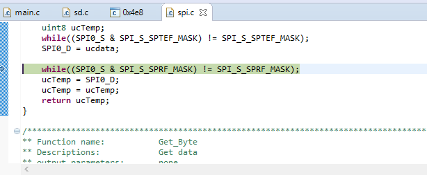

arthshah
hello kerry,
i had done that what you ask for.
here is my debug picture.
7,544 Views

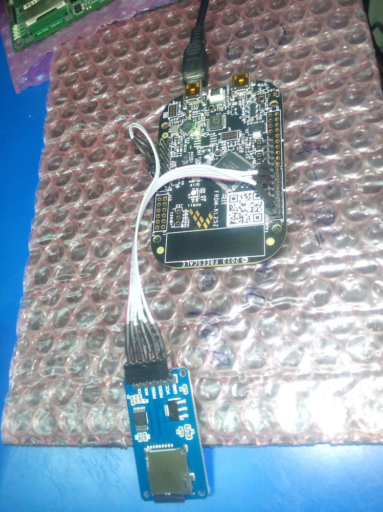

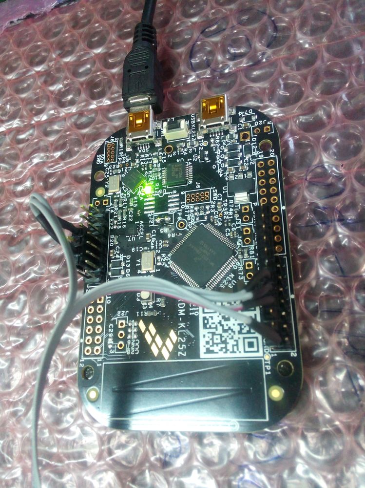

kerryzhou
Hi Arth Shah,
   Give me some picture of your board and SD card connection.
Kerry
7,544 Views
arthshah
hello kerry ,
here is attachment of my board and SD interfacing pictures.IMG_20170510_131946.jpg
7,543 Views
arthshah
7,543 Views
kerryzhou
Hi Arth Shah,
    Thank you for your pictures.
    Please divide all the wire which connect together, now you are using cable which connect all the SPI wire together.
   Please divide it one by one, especial the SPI_CLK, SPI_MOSI, SPI_MISO, then try again.
Kerry

arthshah
hello kerry,
i try this one but still remain same problem on my code,
it's sometime work and sometime not work.
your code is not work still now.
and here i attach my debug picture of my code.
every time my code is stop here.
what's the problem in SPI?
