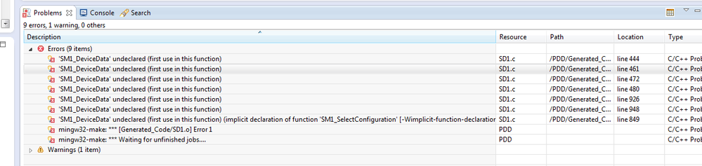

I've a small project with KE02 and SD Card on SPI peripheral, without SO.
I use Fat_FileSystem bean that uses SD card beans and others.
When I build the project I've some errors, in SD1.c file.
you can see
Description Resource Path Location Type
'SM1_DeviceData' undeclared (first use in this function) SD1.c /PDD/Generated_Code line 461 C/C++ Problem

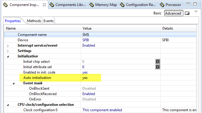

BlackNight
Hi Paolo,
thinking more about it, I think you missed to select 'auto initialization' in the SM1 component:
This will create the SM1_DeviceData in the SM1.h header file.
Erich

BlackNight
Hi Paolo,
Erich
