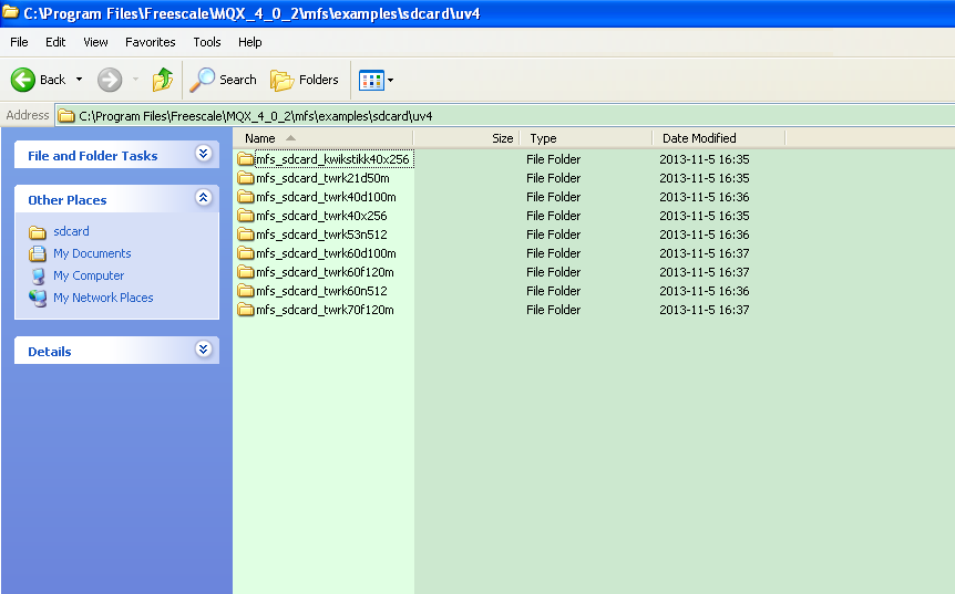

Kan_Li
Hi Swathy Sen,
Actually there is no ready SD card demo based on FRDM-KL25Z, but the MQX 4.0.2 has similar examples for such kind of application. Please kindly refer to C:\Program Files\Freescale\MQX_4_0_2\mfs\examples\sdcard\uv4 for details. You will find SDCARD demos for Keil.
Hope that helps,
B.R
Kan
8,328 Views
swathysen
Thank you for your reply. I do not have such a folder or file path in my system. I have installed Keil in Disk D. I have a path D:\Keil\ARM\Boards\Freescale\KWIKSTIK\. In the same path instead there is a FlexMem_Cfg folder. Are they by any chance the same?
8,328 Views
Kan_Li
Hi Swathy Sen,
You have to download MQX 4.0.2 firstly, and will find such a folder like that after installation . Please kindly refer to MQX: Freescale MQX™ Software Solutions for more details.

swathysen
Hi Kan_Li
I will download MQX 4.0.2 and see once.Thanks a lot.
