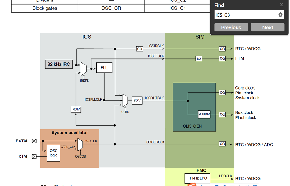

nxf58904
I do know that KEAZN64 has 1024 times the internal .   And from the datasheet, it shows internal clock from 31.25k-39.0625k. The typical value is 31.25k. This value is calibrated by factory .So we need to wite a new trim to ICS-c3.So could you please write ICS_CS =0; Please have a try.

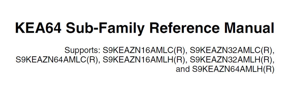

From the reference manual,KEA64 support  S9KEAZN64.
And internal clocking sources is from  31.25-39.0625khz. Which clock do you need to be 40khz.

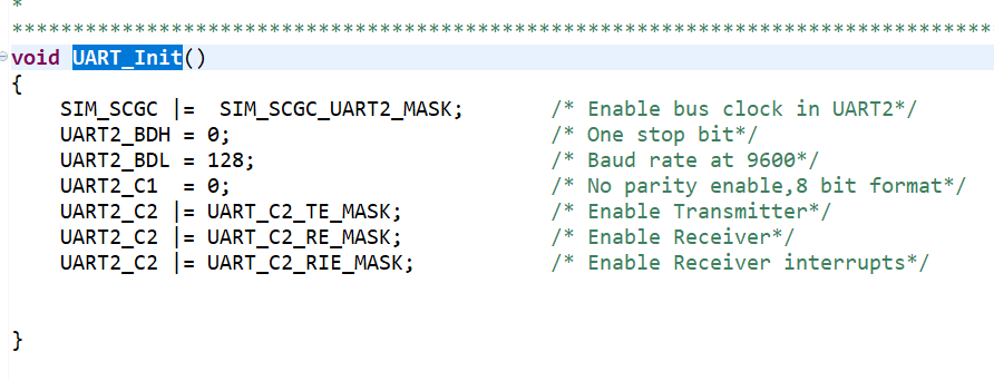

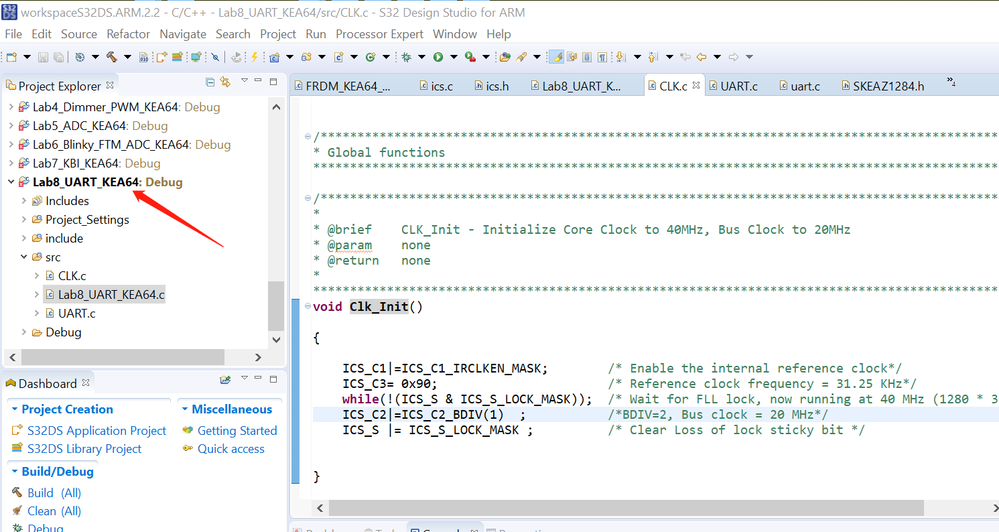

change the internal clock to 31.25 by config ICS_C3,core clock is 40mhz, bus clock is20Mhz.
change uart2 to uart0. and change BDL to 11. The baud rate as shows in follow pic .pastedImage_6.png
Please have a try.

zhangzhiyong
Hi,Jianyu
I tried your suggestion,but it didn't work.
First, KEAZ64 and KEAZN64 are two manuals,and KEAZN64's clock is 1024*31.25, not 1280*31.25.
We configured the clock like this, as you suggested. But the test failed.
