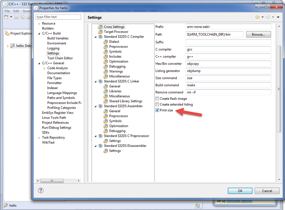

I am using FRDM DEV BRD KEAZ128 and S32.  How to check what is the code size I am flashing to microcontroller?

Please go to Properties for your project, and check "Print size".
I hope this helps.
Iva
