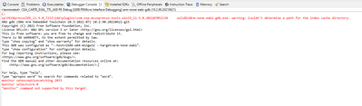

Hello, I am encountering trouble with a demo board TWR-KV58220M.
I use this board to develop an electronic evaluation board for a customer but when I try to debug it, it does not work.
I already used the µC (KV58) for an other application with the same evaluation board and it worked well.
I recently upgrade my MCUXpresso to the last version (11.5.0) and I use the PE micro multilink FX Rev A debugger with (I hope the last version of software, which I have apply an upgrade).
The trouble is as follow :
I created a project with a basic configuration (juste to verify if it works)
I generated the code to init the pins and clocks...
I created a debug configuration with my PE micro tool and when I try to debug, the process runs until 100% but before it finished, the following message appear :
I checked the debugger console and here are the errors I got :
I have already searched solutions on the forum but nothing I found works for me.
has anyone encountered this issue to help me to fix it, please ?

Thanks Robin,
I tried doing this upgrade but no changes...
I think that is my demo board which is dead because I try on another demo board (frdm-K64F) and it works.
I am going to try to debug with another computer to verify if it is not my computer that is the problem.

Hi Bela,
Have you tried to recover the on-board debugger of TWR-KV58F220M? Please refer the answer in: TWR-KV58F220M
https://community.nxp.com/t5/Kinetis-Microcontrollers/TWR-KV58F220M/m-p/930769
Robin
6,637 Views
Robin_Shen
Hi Bela,
Have you tried to update the GNU ARM PEMicro Interface Debugging Support?(Help->Check for Updates )
If still not able to debug, maybe you can submit a question to PEMicro. This error has been discussed in PEMicro forum once: MCUXpresso error 216 problem
By the way, the onboard debugger is able to debug it. You can refer: TWR-KV58F220M
Robin
