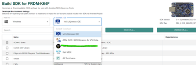

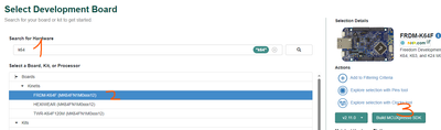

Hello, my name is Pavel, and I will be supporting your case, as normally when you download the SDK look at the image as an example.
You must select the IDE.
Pavel
