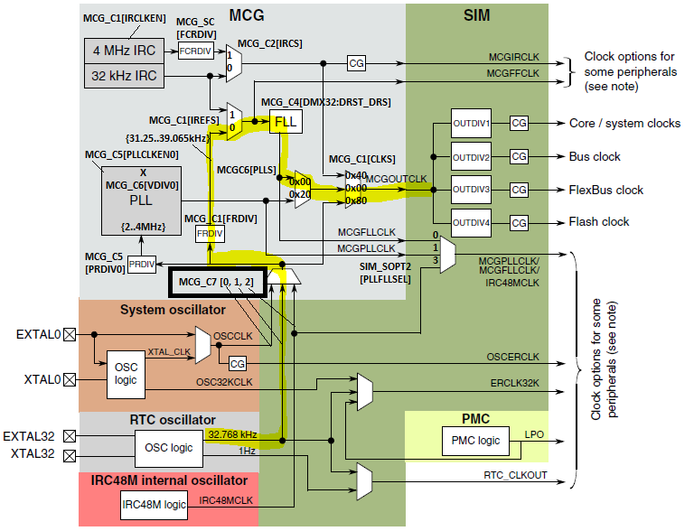

I have been testing various clocking configurations and wanted to try using the 32.768kHz RTC oscillator as external input to the FLL and generate a 95.97MHz core clock.
In fact it looked quite simple to do but I didn't manage it because as soon as the FLL input was switched from the internal IRC to external clock the initialisation would hang waiting for the FLL input to be selected. Before selecting the input I have ensured that the RTC oscillator is running and set the external oscillator for it (MSG_C7 = 1) and FRDIV is 0 (/1) so that the FLL input is at the correct speed.
IREFS can be cleared in MSG_C1 but the status register still shows that the 32kHz IRC is being used.
Here is also the MCG diagram that I use to which I have added register controls so that it is easier to understand and check (showing the path that I would like to switch through)
Note: When testing the IRC48MCLK path I originally had a similar issue in that I was switching the MCGOUTCLK to it but the status register was showing that it was not being used. Only when I remembered that the IRC48M has to be enabled in the USB module first did the status register display that it had indeed been correctly set and so I am suspectig that the signal is not actually at the input (and the switch is not actually switching and the IRC is still being used). But I couldn't see what was missing and no amount of trying resulted in any success.

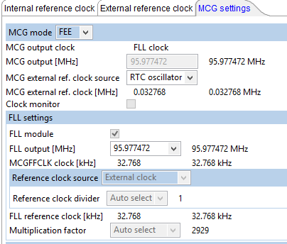

It was one of those rare instances that I decided to see how PE does it right since it obviously had me beat.
So I set up PE to do the same:
And I stepped though the code to get a lesson in how thing should be done....
And what hapens... it gets stuck as well as soon as it tries to switch the FLL input to the external RTC clock source
while((MCG_S & MCG_S_IREFST_MASK) != 0x00U) { /* Check that the source of the FLL reference clock is the external reference clock. */
It spins here forever...
So now I am wondering:
- does my chip have a broken track between the RTC input and the FLL input switch?
- Should the PE code work or has it never been tested?
- Is it actually possible to connect the RTC clock to the FLL input?
Anyone done it successfully??
Mark

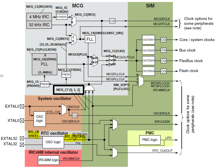

In the meantime I have an explanation why the configuration doesn't "always" work.
See the following code in CPU_init.c (used by PE, or generated by PE (?))
  /* System clock initialization */
#if STARTUP_RTCOSC
  /* SIM_SCGC6: RTC=1 */
  SIM_SCGC6 |= SIM_SCGC6_RTC_MASK;
  if ((RTC_CR & RTC_CR_OSCE_MASK) == 0u) { /* Only if the OSCILLATOR is not already enabled */
    RTC_CR = (uint32_t)((RTC_CR & (uint32_t)~(uint32_t)(RTC_CR_SC2P_MASK | RTC_CR_SC4P_MASK | RTC_CR_SC8P_MASK | RTC_CR_SC16P_MASK)) | (uint32_t)STARTUP_RTC_CR_SC_VALUE);
    RTC_CR |= (uint32_t)RTC_CR_OSCE_MASK;
    RTC_CR &= (uint32_t)~(uint32_t)RTC_CR_CLKO_MASK;
#endif
Notice that the final instruction executed when the oscillator is not enabled is to clear the CLKO mask. If this mask is set the 32.768kHz generated by the RTC is not actually availabe as physical output for use by the MCG, in which case the attempted switch to the external clock input to the FLL 'will' hang.
The probem is that if the RTC on the board is already operating and has the mask set (which was the case when I initially tested) the oscillator initialisation will be skipped and the mask left on, with the result that the clock initialisation fails (hangs).
This means that the CLKO mask reset should be performed unconditionally so that new code loaded to a board that has the RTC already configured can't fail. It should therefore actualy be outside of the if ()
Below I have added the CLKO mask switch to the MCG diagram since it is otherwise not seen and can result in unnecessary study being required in such cases.
Mark

mjbcswitzerland
Specialist V
Hello Neil
I used the same TAB as you to check out what PE did - In one case it worked and in another it didn't. It generates a lot of code, of which just a couple of lines are relevant for this case (and I expect that it wil be quite PE version dependent so you may get different behavior if using a different versions). It is best to start with a deleted Flash and make sure that the RTC has been powered down since the code may not be able to handle the case where the RTC was already running, in case it is being initialised by code in Flash before loading the new code.
Simply writing the handful of lines of code (as above) is as easy and is then reliable (and commented so that it is understandable what it is doing).
I don't think that the fact that the RTC needs a voltage for its registers to be accessed is an errate, but a 'normal' fact since the RTC is powered by this input and nothing else. The effect is easy to test by adding and removing the VBAT power supply but it may not be made that clear in the documentation that one must avoid trying to access it if the supply is missing since it 'does' indeed result in a hard fault.

POWER_UP(6, SIM_SCGC6_RTC); // enable access to the RTC
MCG_C7 = MCG_C7_OSCSEL_32K; // select the RTC clock as external clock input to the FLL
RTC_CR = (RTC_CR_OSCE); // enable RTC oscillator and output the 32.768kHz output clock so that it can be used by the MCG (the first time that it starts it can have a startup/stabilisation time but this is not critical for the FLL usage)
MCG_C1 = (MCG_C1_CLKS_PLL_FLL | MCG_C1_FRDIV_RANGE0_1 & ~MCG_C1_IREFS); // switch the FLL input to the undivided external clock courcse (RTC)
SIM_CLKDIV1 = (((SYSTEM_CLOCK_DIVIDE - 1) << 28) | ((BUS_CLOCK_DIVIDE - 1) << 24) | ((FLEX_CLOCK_DIVIDE - 1) << 20) | ((FLASH_CLOCK_DIVIDE - 1) << 16)); // prepare bus clock divides
while ((MCG_S & MCG_S_IREFST) != 0) {} // wait until the switch to the external clock source has completed
MCG_C4 = ((MCG_C4 & ~(MCG_C4_DMX32 | MCG_C4_HIGH_RANGE)) | (_FLL_VALUE)); // adjust FLL factor to obtain the required operating frequency
PE also enables the second oscillator, which is not necessary and possibly consumes additional and unnecessary power.
Therefore PE is not fool-proof and it is worth analysing what it does and possibly correcting it a little.
If the VBAT of the K64 is not connected the RTC will also not work and any attempt to access it will result in a hard-fault. This was also found in a product development that I was involved with so it is a "general" requirement.
