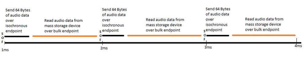

Just want to know how I can send over isochoronous endpoint and receive over bulk endpoint between SOFs.(I have added diagram on community question for reference, what I actually expecting)

What i want to achieve is as follows to run speaker
But whats happening is
Please guide me how i can achieve the 1st image scenario using USB stack, so that full USB bandwidth is utilized.
Thank you.
