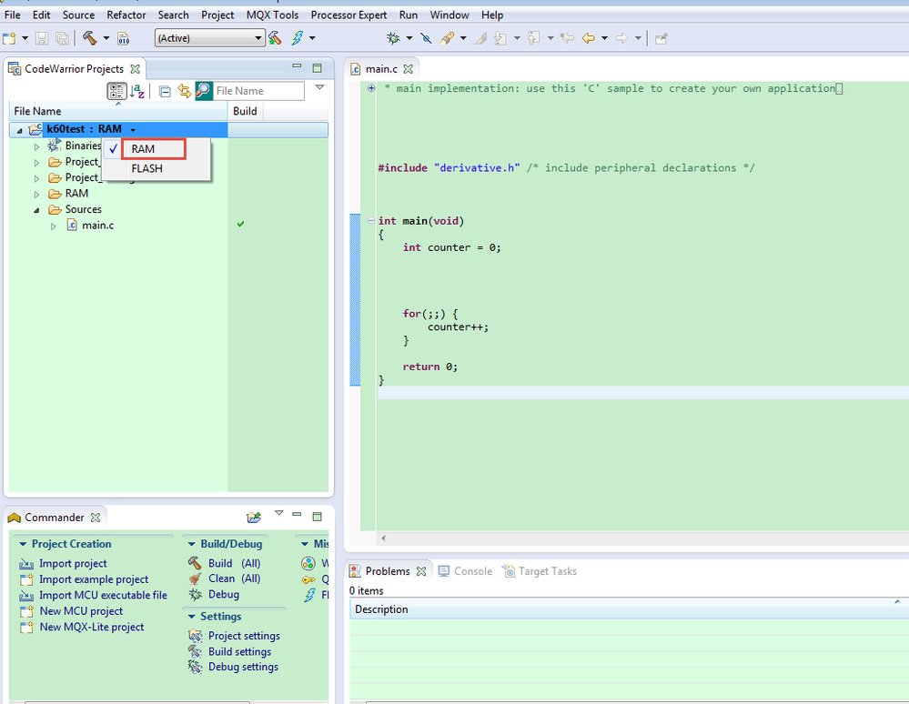

jerrylian
Thanks for all suggestions!
* Erich: your solution is good, but can't solve the main problem: writing to flash is slow!
* Kerry: so I prefer your solution --- download to RAM instead of FLASH.
Now the question:
-----  how can I instruct CodeWarrior to download to RAM, instead of FLASH?

kerryzhou
Hi Jerry,
  When you create the codewarrior project, you will find there a selection of RAM or FLASH.
  If you choose RAM, code will download to RAM:
   But please note, if you download to RAM, after the board is power off, the code will disappear, so if you want the chip still have problem after power off, you should download to the flash.
Wish it helps you!
Kerry

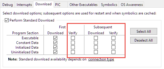

BlackNight
Hi Jerry,
you might check the setting in https://mcuoneclipse.com/2012/10/30/speeding-up-the-debug-launch-in-codewarrior/  to speed up the debug process overall. The other suggestion I have is to disable the verify:
Other than that, you might use a fast debug probe (e.g. Segger J-Link).
I hope this helps,
Erich

kerryzhou
Hi Jerry,
   If your project is very small, you can just download it to the RAM instead of the flash.
  But if your code is very large, and larger than the RAM size, you'd better download to the flash and debug it, then this debug result will be more credible.
Wish it helps you!
