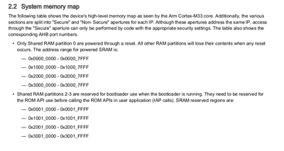

I'm working on MKW38 chipset, and want to keep some data in ram instead of flash when the device resets from application to bootloader side. Maybe I missed something in spec, I didn't find some special RAM related to this, and also the description about how to perform a WARM reset which is occasionally mentioned in TRM. Would you please point a way for such purpose through RAM or registers to pass some data from application to bootloader?

Ill answer here, in case somebody else bumps into this.
First, find in your reference manual a region of SRAM that remains power through a reset. In my case (mx rt 595), thats SRAM partition 0.
It's address range is:
First up, modify your linker script.
1. Add a memory region. In our case, m_persistent. I placed it at the beginning of the above-mentioned partition.

2. Add a section in the memory region.
SECTIONS
  .persistent_data (NOLOAD) :
    . = ALIGN(4);
    __persistent_data_start__ = .;
    KEEP(*(.persistent_data))
    KEEP(*(.persistent_data*))
    . = ALIGN(4);
    __persistent_data_end__ = .;
  } > m_persistent

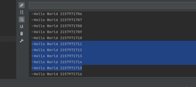

And place your variables in the newly created section. Here's a quick code to test the functionality. It should print the value, increment it, and reset after 3 seconds.

Sample output:

I tried to reset with watchdog which should be usually regarded as WARM reset, but looks like the ram data is still lost during reboot.
2,418件の閲覧回数
xiaofenglei
It's my bad, and the memory can retain content with watchdog. I will use this way.
