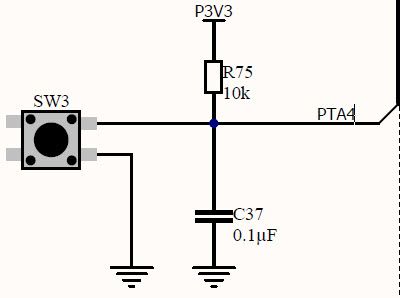

The cause of this behavior is the Non-Maskable Interrupt (NMI) pin on the MCU.  When NMI is asserted low, it forces an interrupt, and jumps to the NMI ISR.  Take a look at the NMI signal on PTA4 pin of this FRDM-KV11Z board:
The cap on this pin keeps NMI low initially during POR, and with the weak pull-up it takes some time to get pulled high.  So reset releases, code starts executing, and it immediately jumps to the NMI ISR and gets stuck there.  This also means code doesn't disable or service the watchdog, so reset gets asserted again.  This continues to happen until NMI is pulled high, and then our application code finally executes.
The Kinetis MCUs do have an option stored in flash to disable NMI on boot, to prevent something like this from happening.  In the KV11, the NMI_DIS bit is bit2 in the FOPT flash location at address 0x40D.  By clearing the NMI_DIS bit in flash, NMI will be disabled.  The SDK projects configure the Flash_Config area using the structure below in the startup file, like startup_mkv11z7.c.  The linker places this Flash_Config section at address 0x400, so the last word contains the FOPT byte for address 0x40D.  The FOPT byte was the default 0xFF, and was changed to 0xFB to clear the NMI_DIS bit2.  BTW, the 0xFE byte in the same word is the FSEC byte at 0x40C, and is set to 0xFE to leave the MCU unsecured.

} Flash_Config = {0xFFFFFFFF, 0xFFFFFFFF, 0xFFFFFFFF, 0xFFFFFBFE}; // NMI_DIS cleared in FOPT

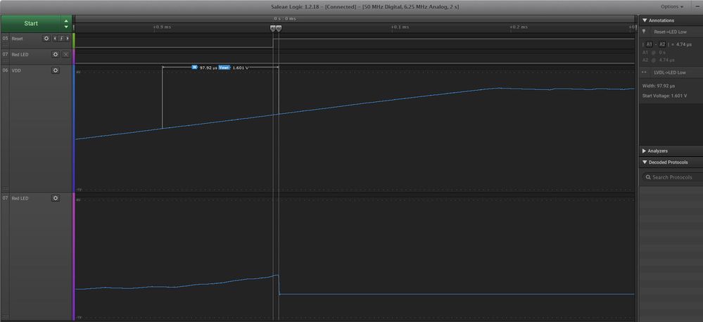

Now with NMI disabled, the capture below shows the final results.  Reset no longer toggles, and only goes high once.  The LED pin is driven low so quickly, the logic analyzer on the digital signal does not even recognize it goes high.  The bottom channel is analog voltage of the LED pin.  It starts to rise with VDD until the code executes and drives it low.  This is 5us after reset is released like we saw before, but is only 98us after VDD=1.6V.  Much better!
