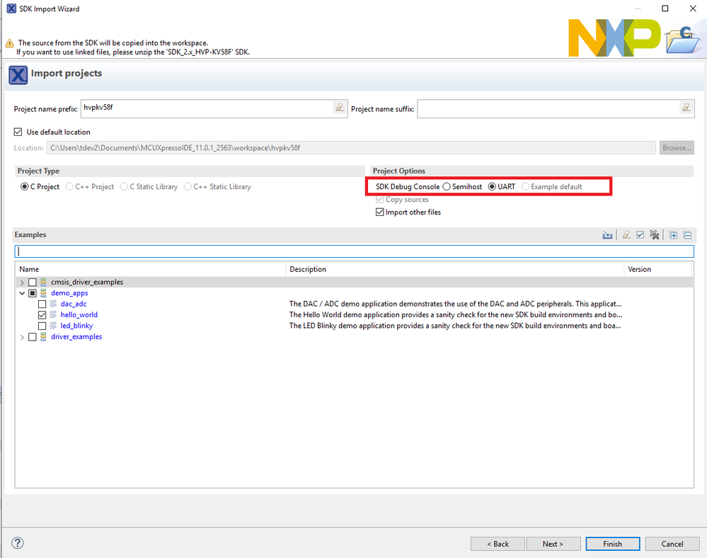

Hi Jeff,
Please download HVP-KV58 SDK from Welcome | MCUXpresso SDK Builder  and try again.
Semihost use UART port. In HVP-KV58, openSDA connect to UART1. But in TWR-KV58, openSDA connect to UART0. So, semihost connection can't establish.
Jing

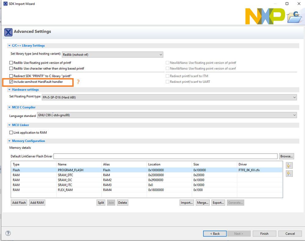

Jing,
I am importing hello_world application from the HVP-KV58 SDK v2.6 on MCUExpresso 11.0.1
Base on  you suggestions this what I tried.    See screen dumps and code.
OK here was what I tried this morning.
#ifndef _BOARD_H_
#define _BOARD_H_
#include "clock_config.h"
#include "fsl_gpio.h"
* Definitions
/*! @brief The board name */
#define BOARD_NAME "HVP-KV58F"
/*! @brief The UART to use for debug messages. */
#define BOARD_USE_UART
#define BOARD_DEBUG_UART_TYPE kSerialPort_Uart
#define BOARD_DEBUG_UART_BASEADDR (uint32_t) UART1
#define BOARD_DEBUG_UART_INSTANCE 1U

But this time I got the following error
However,   I think I may have narrowed in this issue to be a FLASH write error.
PEGDBSERVER_CONSOLE OUTPUT
Loading programming algorithm ...
Done.
Programming sequency is : erase, blank check, program, and verify {default}
CMD>VC
Command is inactive for this .ARP file.
VC is not implemented, falling back to VM
CMD>VM
Verifying.
Verify error at address $10000002.
Byte in module is $00 and should be $02.
Current content of flash does not match application to be programmed
CMD>EM
Error Erasing flash of device
Error occured during Flash programming.
The question is why.   Is the algorithm, the location or a issue with the hardware?
