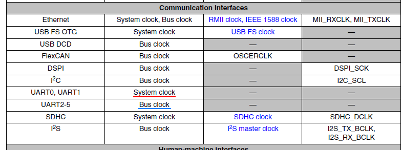

I an facing problem with the working of UART4. UART1 is working fine but UART4 is working half the baud rate with the same configuration as UART1. Can anyone help me  why this is happening  or solution to correct it? Below is the configuration setting written in code for UART1 and UART4.

Hi chandan,
UART0 and UART1 modules operate from the core/system clock, which provides higher performance level for these modules. All other UART modules operate from the bus clock.
Please check the value of SIM_CLKDIV1[OUTDIV1] and SIM_CLKDIV1[OUTDIV2]. If you don't want to change the frequency of core/system clock and bus clock, then you can't use the same configuration settings.
