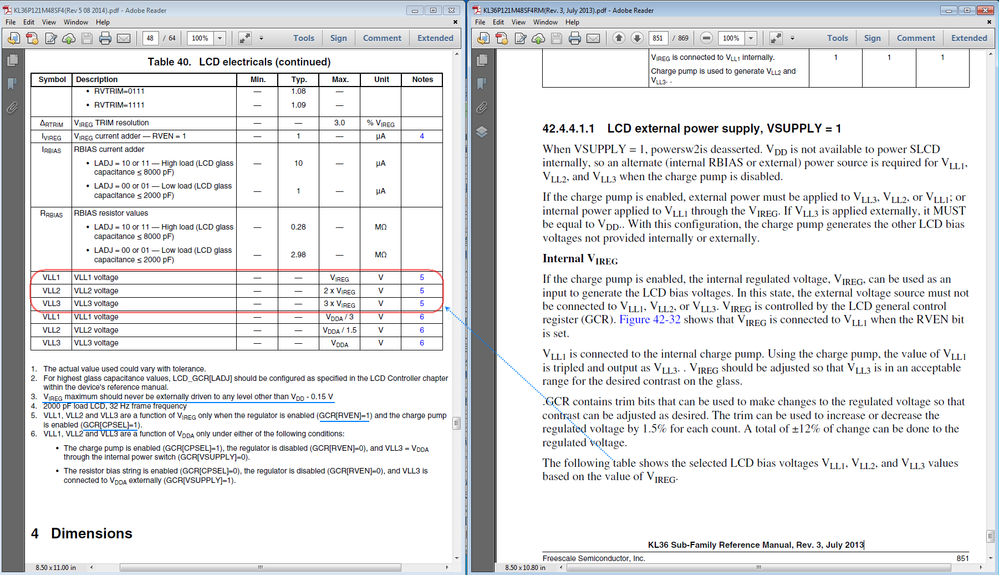

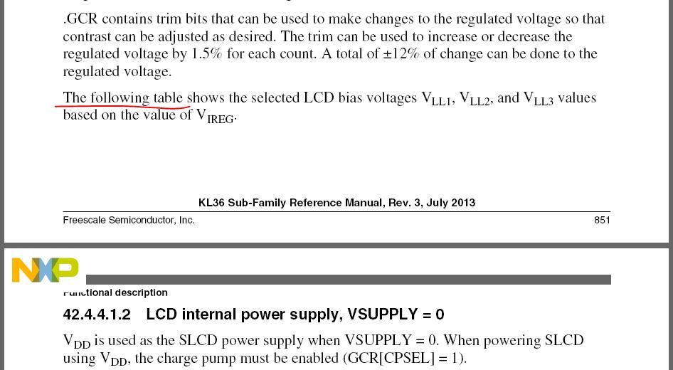

Hi.  In "KL36 Sub-Family Reference Manual" page 851, the spec says "The following table shows the selected LCD bias voltages VLL1, ......"  However, there is nothing down there.  And I can't find related information throughout the manual.
Is a table missing here?  I just want to know the range of VLL1, so I can tell what LCD voltage I should use.
Thanks for the help.

Hi Thoma,
Sorry for our document issue may bring any inconvenience to you. I will contact doc team to update it in next version!
You can find related information in "Table 40. LCD electricals" of KL36P121M48SF4.
