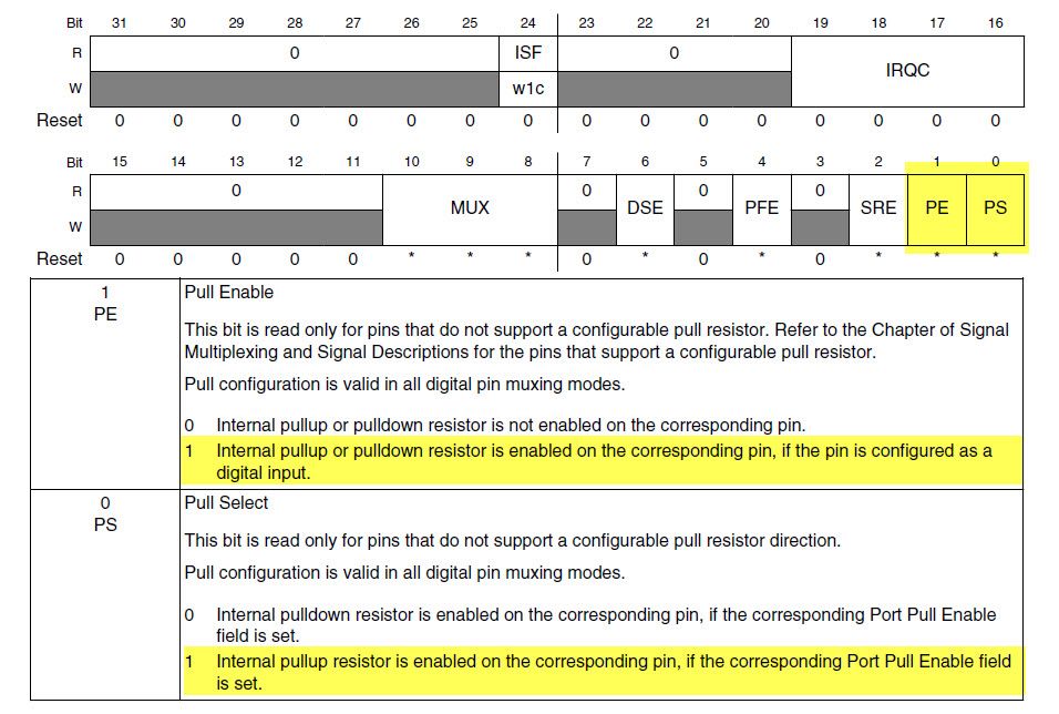

You need to enable the internal Pull-up for the pin since in the Board are not externally pulled-up. To enable the pull-up you need to write 1 to the PS and PE fields in the PCR register.

You can select a pull-up or pull-down internal resistor for the pins. There are some pins, like the SDA and SCL for I2C functionality, that are configured as true open drain when selected; in this case the pull up or down internal resistor has no effect on them.
You need to consider also that according to the Datasheet the internal pull-up resistor has a value of 20 to 50 kOhms, it will probably will not be enough for some applications but, like in this case, will help you to ensure a constant value in the pin.
You can pull-down the PTC3 by selecting in the PORTx_PCRn register PE= 1 and PS= 0.

According to the schematic the Button is connected to GND, this means that any time you pressed the value it will drive is 0 (zero). The same way with the internal pull-down the value of the pin is 0 and when you press the button the value will not change.
Using the pull-up the value of the pin is 1 and when you press the button the value will be 0 because the button will short to GND. This means you cannot use pull-down for the button.
