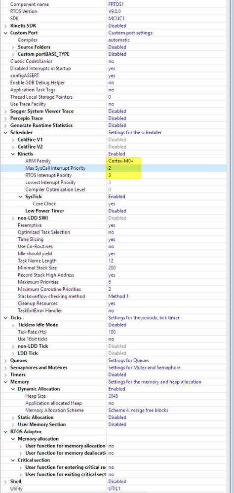

Hi Josiah,
there is an open source Processor Expert component available with the McuOnEclipse project, see McuOnEclipse Components: 12-Dec-2016 Release | MCU on Eclipse  for the latest release. The download (make sure you install both files) is on SourceForge, see McuOnEclipse Releases on SourceForge | MCU on Eclipse .
Here is how it looks:
As the SKEA is a Cortex-M0+, make sure you configure it for the M0+:
I hope this helps,

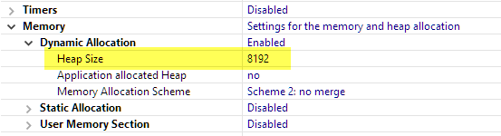

BlackNight
Hi Josiah,
yes, you are running out of heap memory. The size of the heap is specified (in bytes) by configTOTAL_HEAP_SIZE in FreeRTOSConfig.h. See FreeRTOS - The Free RTOS configuration constants and configuration options - FREE Open Source RTOS f...  for a list of configuration items.
In the component there is a setting for this:
Erich

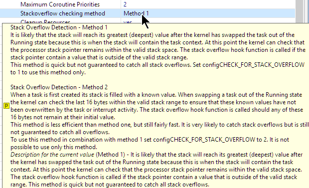

you won't get a clean error for stack overflow, but there is a stack overflow hook you can use:
Read as well FreeRTOS - stacks and stack overflow checking .
