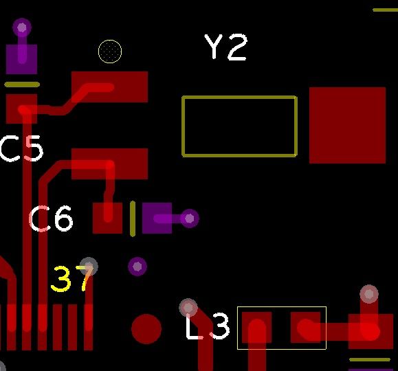

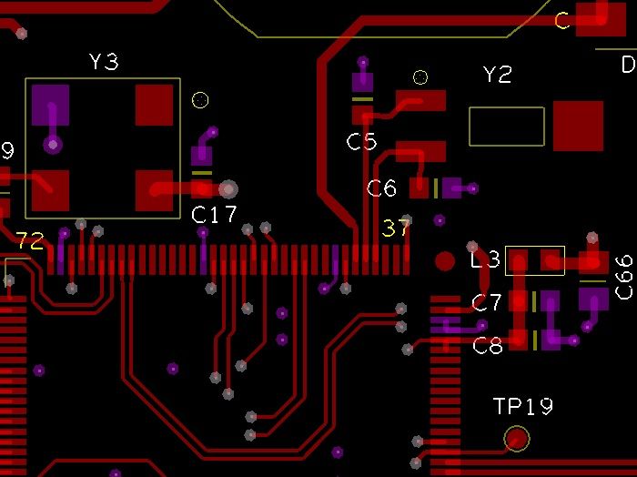

Attaching the Layout screenshot of crystal connection. PFA.

The layout of Y2 looks very good.  I wouldn't expect any issues with the way things are wired.  Just to confirm, Y2's body is not soldered to the PCB - correct?
Now the question to ask is; what happens if you swap some of the crystals?  Does the crystal operation behaviour move with the crystals?  I would suggest just swapping the two on the boards you've removed C5 & C6 from and see if one works with the internal 8pF (where the other one doesn't) and the other with the internal 4pF (which works fine at 8pF).
Going further, you might want to take C5/C6 off from a couple of the boards that are working fine with them on and try different internal capacitor values.
I hate to blame parts but is there any reason why the crystals might be radically different in operation?  I wouldn't expect Citizen crystals to be problematic but you should check the lots and maybe make an enquiry as to the expected variance between parts (which I would not expect to be capacitances ranging from 4pF to 20pF).
