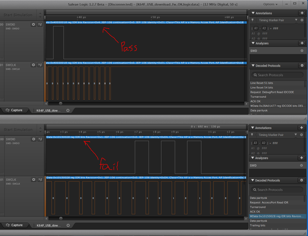

I have a question about SWD flash programming by using two different FRDMK64F boards, I use one of FRDMK64F board to verify my project but in some reason the MK64F chip is broken, so I bought a new MK64F chip to change it to the FRDMK64F board (named "board1"), and another FRDMK64F board used as backup solution (named "board2").
But I can not flash the FW code correctly by board1, and I checked the HW circuit was not shorted or damaged, so I checked the flash protocol with Logical Analyzer.
Then I found the difference in past steps. In step about read component ID register data, I got two different outcome:
"0x40030018"(board2) & "0x10150028"(board1).
next step, I used JLINK debug tool to connect & flash board1 directly (not using the MK20DX chip on board1), the FW was flashed successfully and worked like the board2.
The final verify step, I using Kinetis to write a sample blinky code and debug it with openOCD, then the amazing thing was happen, the FW was worked successfully, too.
is someone know what point cause the different behavior?
the attached file is the capture data by Logical analyzer(saleae)
Original Attachment has been moved to: board1_download_fw_FAIL.logicdata.zip
Original Attachment has been moved to: board2_download_fw_OK.logicdata.zip
Original Attachment has been moved to: fail.txt.zip
Original Attachment has been moved to: pass.txt.zip

michael_galda
You have answered yourself. I remember the same case, when I was playing with this.
The OpenSDA onboard programming FW (in K20) is tied to the device ID originally placed on board.
So if you replace the main device on the board, the OpenSDA will not work.
We have discussed with PEmicro and board manufacturing team and the reason is that they want to protect their business with stand-alone programming tools. (not allow to use the on-board OpenSDA as the external programming tool for other devices)
thanks,
Michael

Hui_Ma
I use J-Link Commander tool to read two FRDM-K64F boards MDM-AP IDR value, which is not same for each board.
If the JTAG interface and on board OpenSDA debugger tool works with new mounted K64 product, that means the debug interface without any problem.
Then customer also could try a complicated application, such as Ethernet to check if other features working as expected.
Wish it helps.
