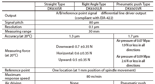

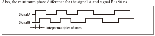

NXP should be aware that there are other sources of quadrature position information beyond simple motor-shaft-rotary.  Here is a datasheet-screenshot for a linear-position-encoder, which resolves 0.1um information over 30mm (other models are longer).  The stated 80m/min potential slew-rate implies an edge rate (at 10million-steps/m) of 13.33M/s --- and the extended info indicates a minimum 50ns between quadrature events.  So quadrature-decode-speed is NOT a 'moot point'.
The other serious trouble I have using these things on Kinetis is the limited 16bit counters in FTM, even though these are inherently 32-bit processors.  A 100mm probe at 10million/m comes to 1 million steps, or about 20bits needed.  I use the 'overflow' to extend the count, BUT have a 'serious limitation' in that the overflow interrupt doesn't differentiate which DIRECTION of overflow, or buffer multiple events should the encoder quickly jitter right at the overflow point.
