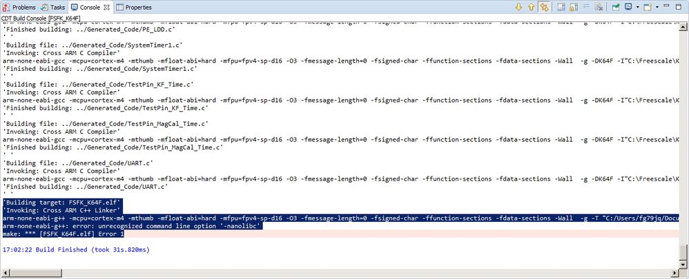

I am doing a senior design project that is using the Freescale Sensor Fusion board with the FRDM-K64F MCU. At the moment I am not able to program the MCU. There is documentation available that has an example lab to build the default program that the board comes with. When I follow the steps a binary file is built but if fails to load. If I load the binary file myself the and open the sensor fusion toolbox the device can't be found. So obviously something is going wrong when building this file. If I load the pre-compiled binary file that is provided the board works again. I have followed the lab step by step, even making a change to CPU_config.h that is needed for K64 MCUs. At this point I am not sure what to do. Anybody have any thoughts?

Our problem isn't actually connecting to the board. We are able to drag and drop binary files into the drive and the file will load. The problem we are having is using the Kinetis or Codewarrior IDE to create a working binary.

So you mean everything is fine when you load the pre-compiled binary into K64 Freedom board, but you have problem to build either CW or KDS project and load the generated binary file into Freedom, right? Which IDE you use? CW or KDS? And are you trying USB interface or bluetooth interface?

haneybriggs
Yes that is correct. We are using the KDS but have tried on both IDEs. And we are using USB interface.

Does this happen with custom project or example project?
By default CW and KDS do not generate binary files, but you can enable the generation, so how did you set it?
Your initial post says:
...a binary file is built but if fails to load.
How are you loading the binary and what do you mean with "it fails to load"? Please elaborate on this (e.g. with a screenshot).
If you can share a project to recreate the issue that would be helpful.

haneybriggs
Right now we are trying to follow part 7 of the AMF-CON-T0756_Sensor_Fusion.pdf that comes in the training documentation of the sensor fusion board. (Downloaded from the last link on this page: Sensor Fusion Development Kit|Freescale ) .  I am using the Kinetis IDE for this.  I follow the steps, to the point that it says to highlight the project and click build. I watched the console window as it goes through the build process and get the following error.
