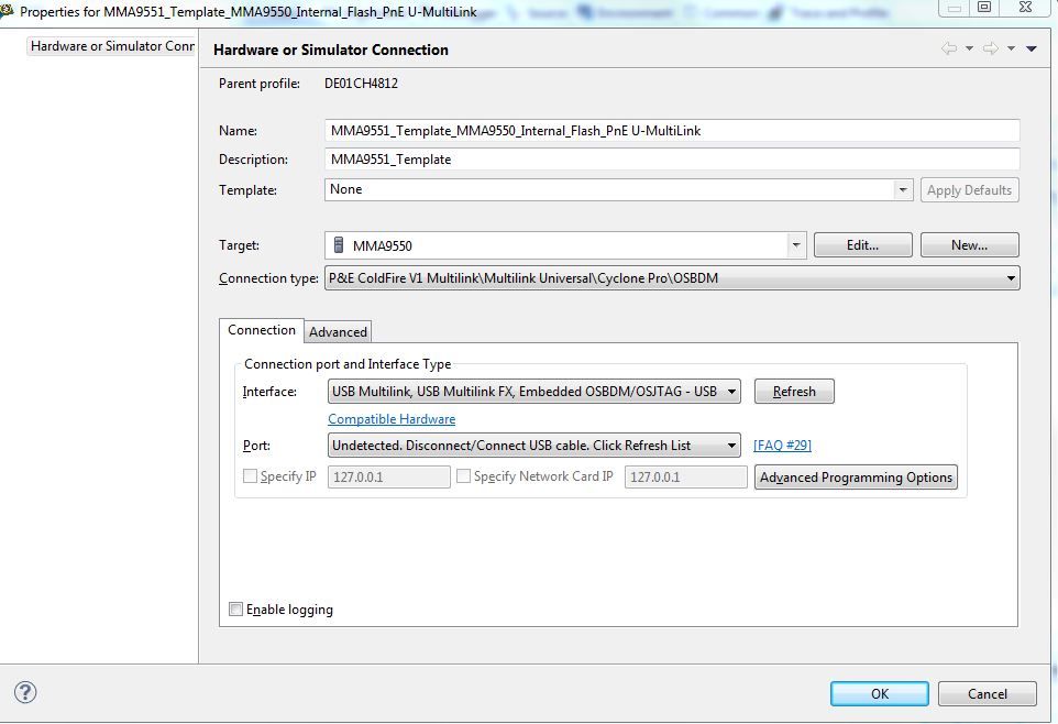

_markus_
Hello Jungjing and all other :-)
I think I have the same problem. I have a Sensortoolbox evaluation board and I can't get in connection.
The problem is that the port will not detected. I have tryed many time to install the driver from P&E. But no success :...(
And It looks like I have a diffrend version of code waarior than you. I use 10.6.
Please can give me somebody some assistance?
THANK YOU ALL!!!

kerryzhou
Hi markus,
    Your problem is not caused by the CW10.6, your problem may caused by your Multilink, you should install the PE Multilink driver and make sure the hardware of your USB multilink  is not broken.
    It seems that your USB multilink still not connect correctly to your PC, about this question, I think you should ask it to the P&E micro's engineer, they may help you install it correctly. P&E 's web is : www.pemicro.com
    Wish it helps you!
