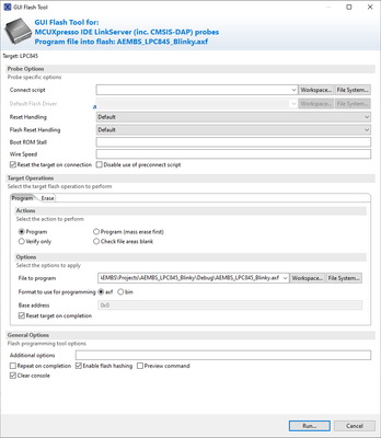

Dear,
I have a question (maybe stupid): It is a lot of times that I develop my project with MCUXpresso and when the board go in production, I still program the board with MCUXpresso and the project opened. I think is not the correct way, with other microcontrollers I use a specific tool where I can download directly the hex file. Is there a similar tool for NXP, in particular the Kinetis series?

There are different ways, depends a bit on the debug probe used.
For LinkServer you can run a script as shown in https://mcuoneclipse.com/2020/12/05/standalone-and-command-line-programmer-with-mcuxpresso/
For P&E (PEMicro) or Segger you can use gdb: https://mcuoneclipse.com/2015/03/25/command-line-programming-and-debugging-with-gdb/
Or you can buy one of the production programmers (Cyclone from P&E, Flasher from SEGGER), see https://mcuoneclipse.com/2016/04/02/flashing-many-arm-boards-without-a-host-pc/ then you can even do the programming without a host PC.
The other way is that you have a bootloader on your device, then you can program it directly e.g. over USB or with blhost:
https://mcuoneclipse.com/2018/03/03/flash-resident-usb-hid-bootloader-with-the-nxp-kinetis-k22-micro...
I hope this helps,
Erich

MarcoGiammarini
Thanks, @ErichStyger  for the reply. I use both P&E Micro and Segger to develop. I was hoping there was a simpler solution, like STM32CubeProgrammer. I'll try your solution with gdb.
Marco
8,510 Views
ErichStyger
Specialist I
Hi Marco,
the MCUXpresso IDE has a similar programmer built in as 'GUI Flash Programmer':
Erich
