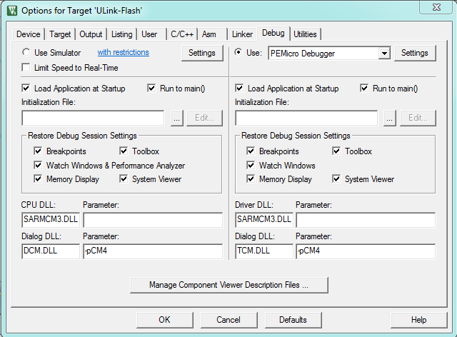

I tried copying the example blinky code given in the boards example in keil.
I dont know which debugger to choose.
I chose #pemicro Debugger
And, Selected the device as below and tried to load the code.
It is showing error.

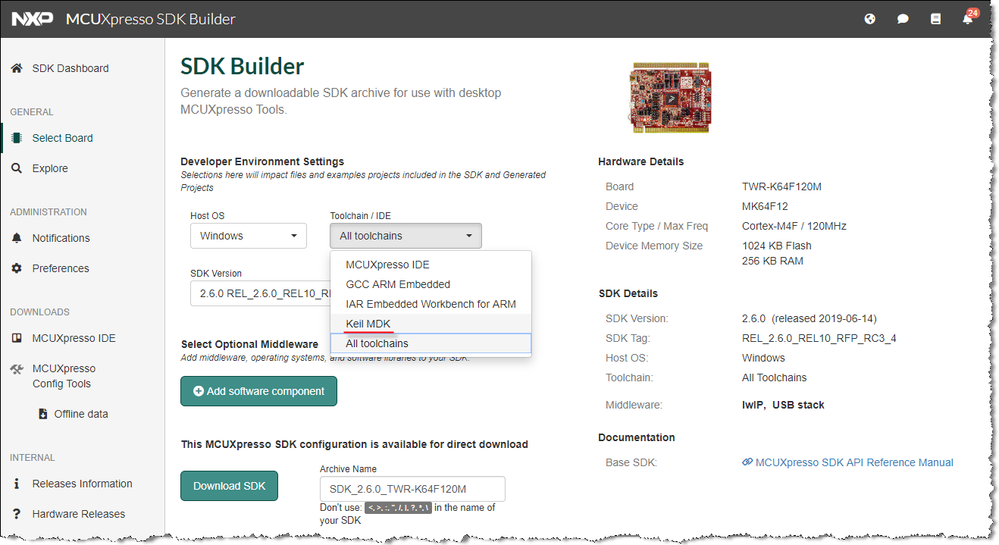

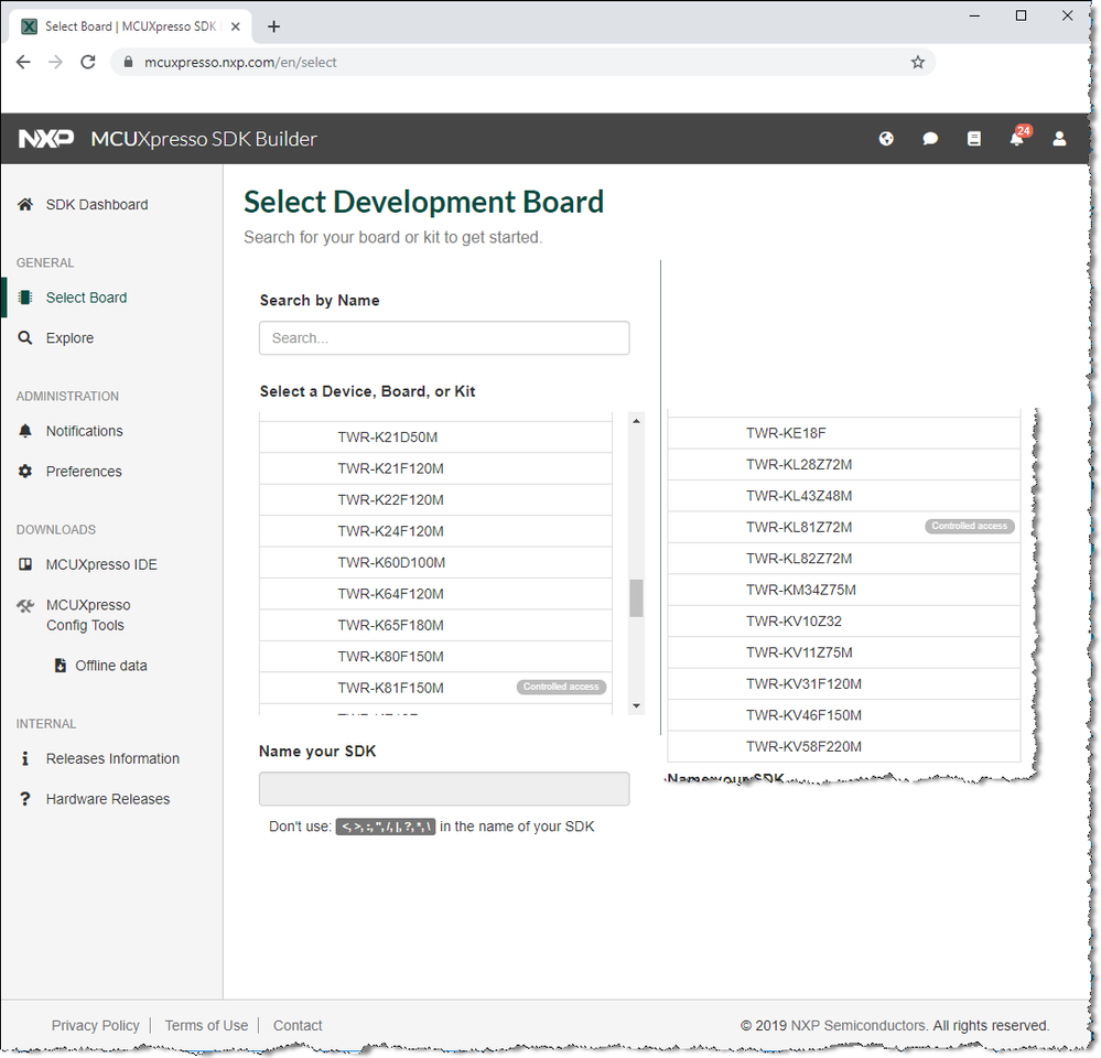

Robin_Shen
Hi Vibhu Sounder,
Considering you are new to freescale/nxp controllers, MCUXpresso SDK supported MCU or TOWER board are recommended.
Unfortunately the TWR-K70F120M(K60 K70 120MHz) are not in the support list of MCUXpresso SDK.
For the MCUXpresso SDK supported controllers, you can direct get Keil MDK based examples.
The way you select debugger seems correct, maybe caused by wrong project setting.
I didn't found Keil project that you mentioned, so can't test it on my side.
You can have a look at this free software: Overview of MCUXpresso IDE v10.2.0

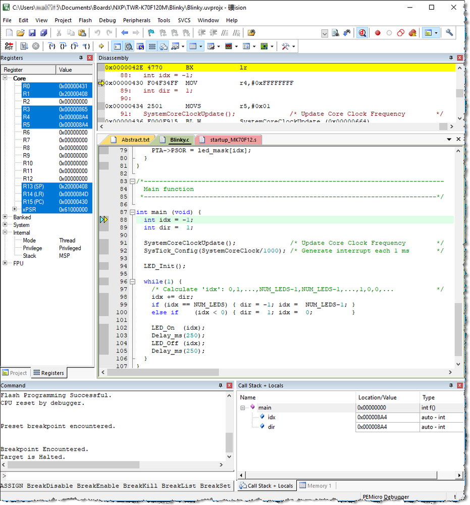

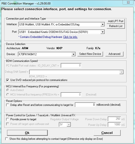

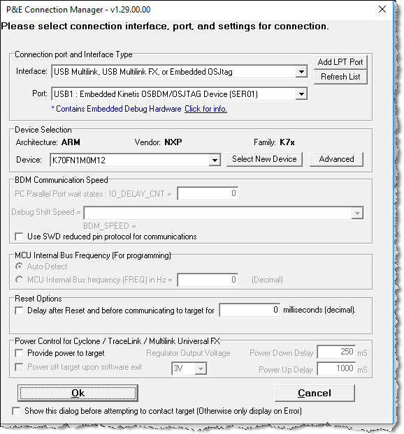

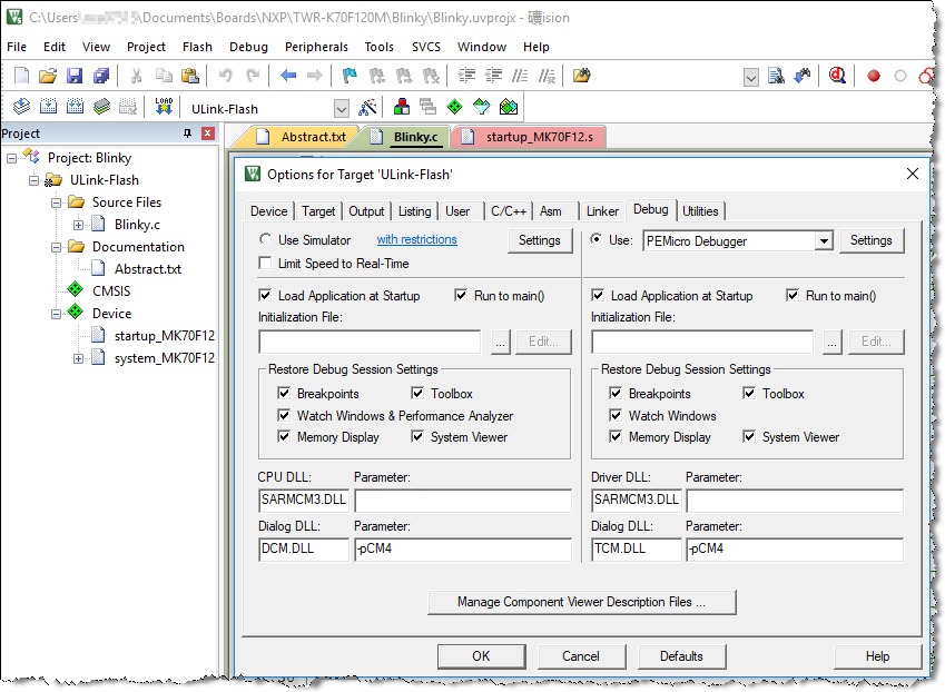

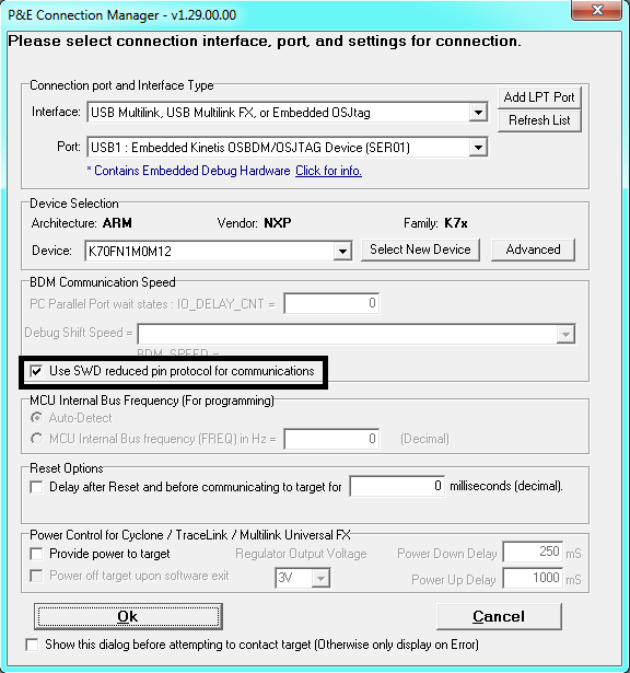

Robin_Shen
I am using Keil MDK V5.23.
I can import the Blinky example now.
After build the example, the on board PEMicro Debugger is able to work.
Here is the default setting of debug configuration.

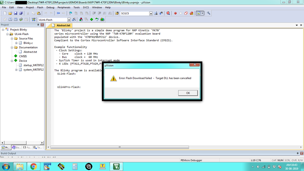

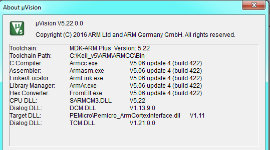

vibhu
Hi Robin_Shen,
I am using keil version 5.22.0.0
It is throwing that error whenever I click on the debug icon.
I have the same configuration as you mentioned.
However the highlighted part seems to re-enable itself when I disable it. Is there any problem because of it ?
The P&E connection manager seems to be able to detect the port of my device, If I disconnect my device it is showing no port found. So what else can be the issue ? Is there anything else which I need to install before using keil ?

Robin_Shen
If you have the same version keil MDK, then you can install it and have a try to test it.
12,738 Views
vibhu
Hi Robin,
Thank You for your suggestion.
I downloaded the latest version of keil - 5.28 and tried to flash the code to twr k70 and now I am able to flash the code to the board. The example LED blink is happening.
