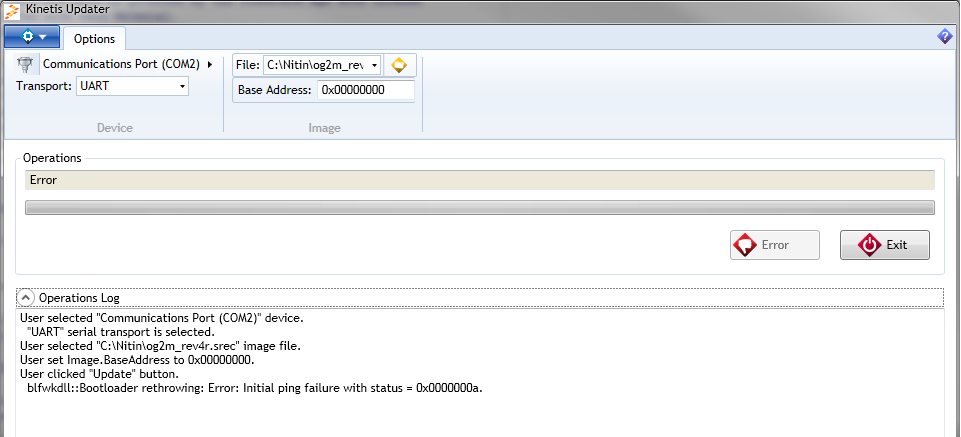

Hello Freescale Folks
I am trying to program MK64FN1M0VMD12 using FSL Kinetis Boot loader tool with serial port and always getting the following error
blfwkdll::Bootloader rethrowing: Error: Initial ping failure with status = 0x0000000a.
What am I doing wrong ?
Kindly help.

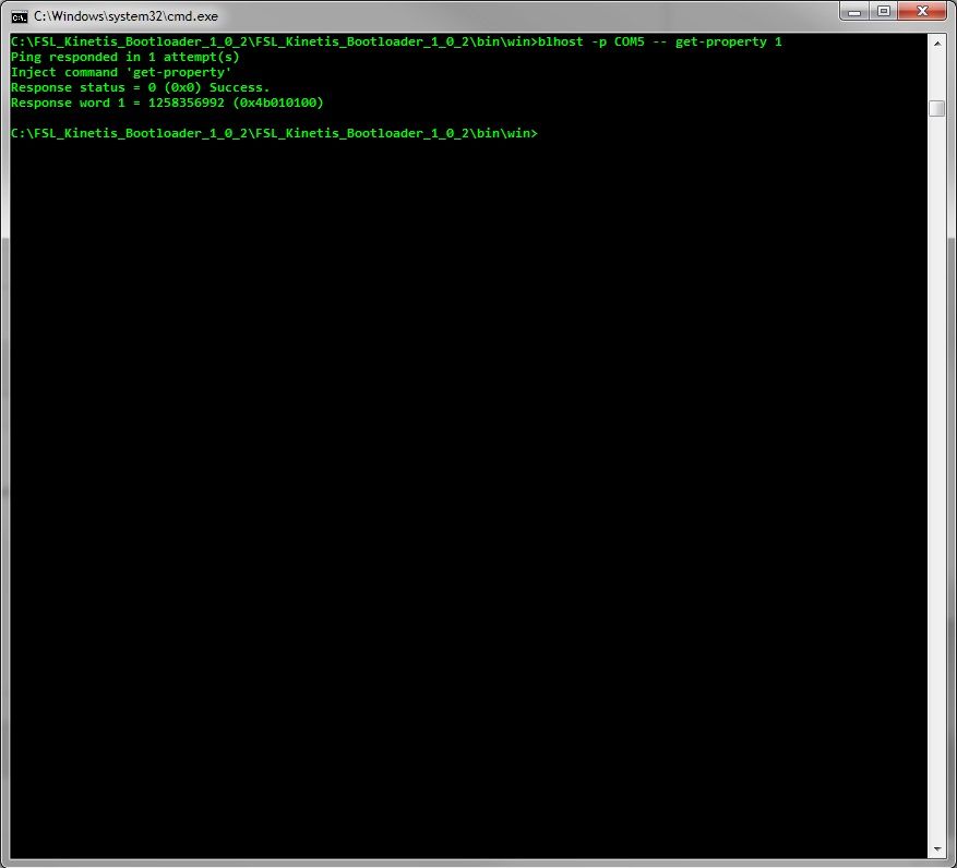

Gentlemen
I think I resolved the issue, With default FSL code, it was one of the Interrupt Service Routine name for UART was calling the UART number (void PORTB_IRQHandler(void)), I renamed it to match my board's usage (void PORTD_IRQHandler(void)) in hardware_init_MK64F12 and boot loader worked just fine. Rest assured all my other board related changes were working fine.
Attached are the outputs of it:
THANK YOU EVERY ONE FOR PITCHING IN ! Very MUCH APPRECIATED.
K64 side:
WINDOWS SIDE:

nitinharish
Contributor V
Gentlemen
K64 side:
WINDOWS SIDE:

adriancano
You need to set the Base address to 0x0000A000. This is the address where your application starts just like the K64BTLDRUG document mentions in the step 7 of the section 6.
Also ensure that the COM port is the right one of your board, you can check the state of the bootloader using the Host Utility application like in the section 5 if the document.
I hope this information can help you.

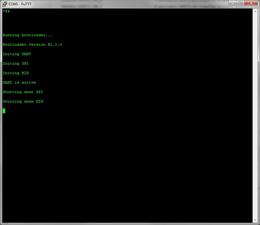

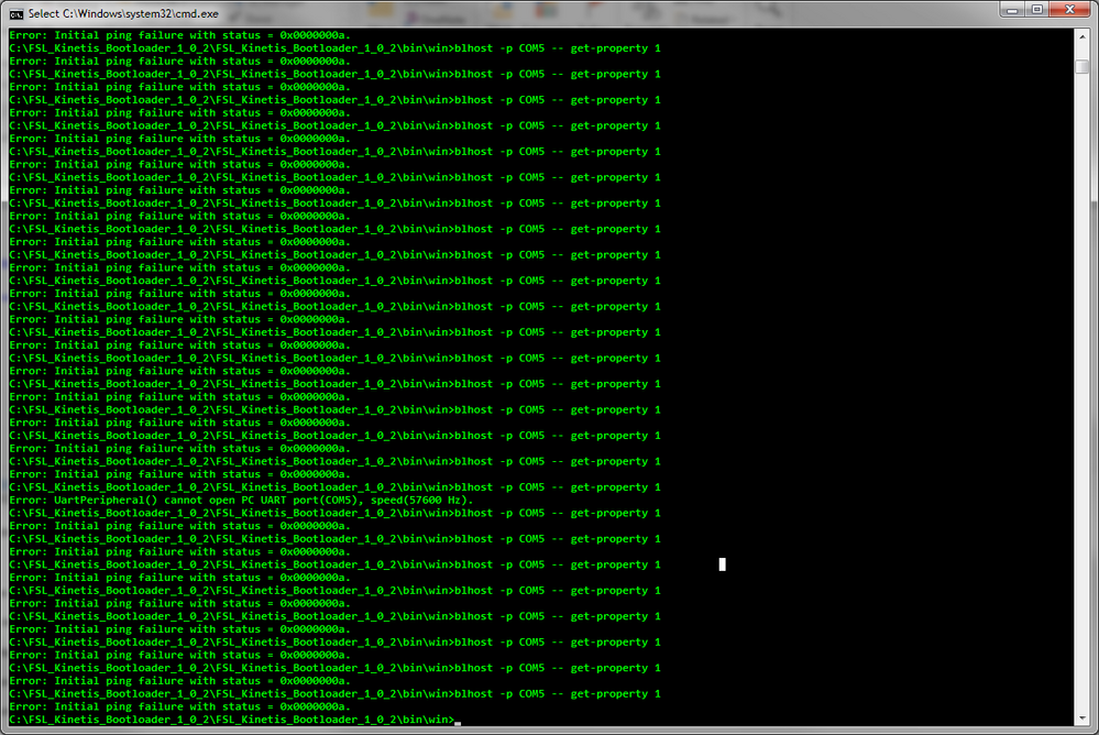

nitinharish
Contributor V
Adrian
I started experimenting with "blhost"  (not for uploading anything, I think this has nothing to do with Base Address) but just to query the K64's boot loader from Windows PC (Note that my bootloader in K64 talks to Windows PC as I can send chars from bootloader and see them on Windows PC @ COM5).
Attached is my output:

mjbcswitzerland
Specialist V
It sounds as though your board is sending UART data but are you sure it is at 57600Baud?
Do you know that your board is correctly receiving UART data? If not it won't respond to the test PING that the program is sending to it.

nitinharish
Contributor V
Yes, Mark my Baud is correct.
I fiddled with it and if it is NOT set to 57600 on both ends, I do not see my character sequence in Putty (on WIN side).
So, YES when I sent you the screen shots, my baud for both ends (Putty) and K64's Boot loader are set to 57600.
With IAR debug stepping it seems though that my K64 bootloader is looping in  "get_active_peripheral"  that is effectively making it stay in "bootloader_init" ? Any ideas why that is happening ? ? ?

mjbcswitzerland
Specialist V
This means that here is no UART operational connection between the program and the UART on the K64. Have you loaded the loader to the K64 and is it connected to the right UART? Also ensure that you have 57600Baud since the loader works with this as fixed speed.
