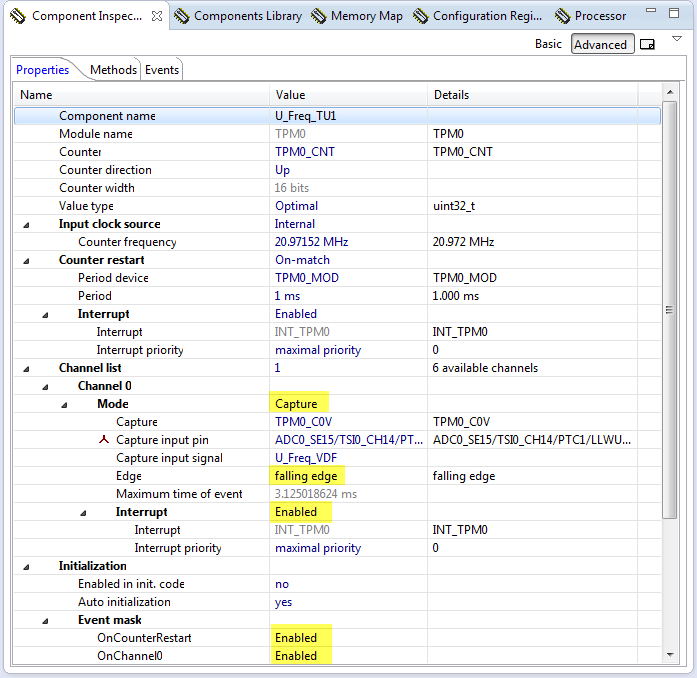

BlackNight
Here is how I did it:
This is where I measure it:

I'm using the TimerUnit_LDD as input capture:
The input capture is configured like this:
I hope this helps.
Erich

4,378 Views
BlackNight
Hi Bob,
see the last screenshot in my answer: it is pin PTC1.
Erich
