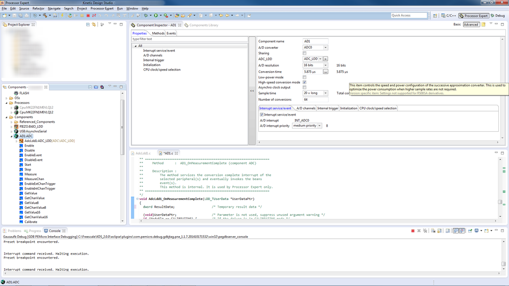

in the last days I've been trying to configure the ADC-Component of the processor expert to do an average over 32 samples.
When setting number of conversions to 1 everything works fin. But as soon as I set the number of conversions to another value the conversion routines calculate false values.
As far as i can tell there is a bug in the generated code (or in my configuration for Processor Expert):

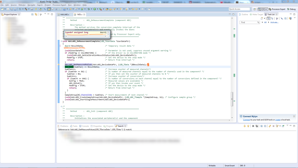

The OnMeasurementComplete-method of the ADC-LDD component uses a DWORD to save the result of the conversation:
dword ResultData;               /* Temporary result data */
ResultData is passed on as a pointer to the GetMeasuredValues-method.

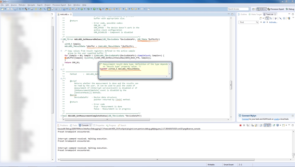

the GetMeasuredValues converts this pointer to a pointer to AdcLdd1_TResultData (which is a typedefed as a uint16_t).
This causes the processor to write a u16-value into the dereferenced dword-variable, which wreaks havoc in the OnMeasurementComplete-method.
My opinion is that the variable ResultData should be of Type AdcLdd1_TResultData in order to work properly.

Yes ,the AD2_OutV is defined to "word", while in this function :
"LDD_TError AdcLdd1_GetMeasuredValues()"
the code "AdcLdd1_TResultData *pBuffer = (AdcLdd1_TResultData *)BufferPtr;"  it forced BufferPtr point to 16 bit space , so  there is no error .
If use pBuffer ++  save the data of ADC result , there will be error .

Please find attached a demo project for the FRDM-K20D50M:
The code generation for the ADC is disabled in this demo project because I left a comment and a breakpoint in the ADC-Routines.
As soon as I set the number of conversions to a value other than 1 the temporary variable "dword ResultData;" is introduced to the AdcLdd1_OnMeasurementComplete()-function.
This variable is neither initialized to zero, nor completely overwritten in the getMeasuredValues-Function.
As far as I can see this causes wrong output values.
Since it depends on the initialization-value of ResultData (which depends on the current stack content) I couldn't reproduce the error I am seeing in my project, but if I
  • change ResultData to type AdcLdd_TResultData
or
  • initialize ResultData with zero
the wrong measurements will disappear immediately.
