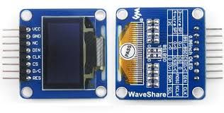

I am facing a strange problem on a K64F interfaced to an SSD1306-based 128 x 64 OLED Display (following images); I use the FRDM-K64F and a FRDM-KL25Z with the MBED platform.

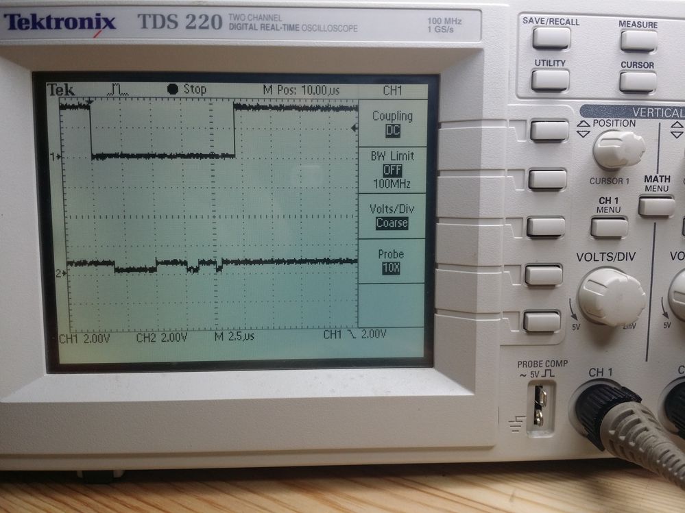

When I use the OLED display on the SPI port of the FRDM-KL25Z it works properly; when I use the same display or a twin one on the SPI0 port of the FRDM-K64F with the same code, all signals are correct except the MOSI one which is connected to the DIN line of the display: on the FRDM-K64F it appears greatly attenuated (almost with a factor of 10:1) or distorted with the shorter bits greatly attenuated and the display doesn't work at all.
I've tried also to use a different code on the FRDM-K64F sending the result of a 16-bit incrementing counter on the MOSI line and the result is the same: the signal is greatly attenuated until the MOSI line is connected to the DIN line of the display:

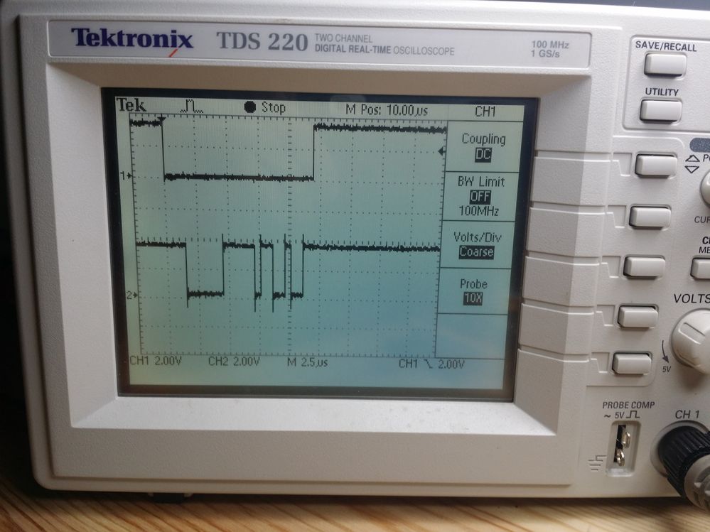

if I disconnect the MOSI signal from the display, it returns normal:
If I recompile and load the same code on the FRDM-KL25Z, the MOSI signal is always perfect!
NOTE: on both the previous pics the top waveform is the CS signal (used as the trigger) and the bottom signal is the MOSI one.

It was related to an undocumented configuration of the SPI port of the OLED display: on both my display samples (manufactured by WaveShare, .96inch OLED (B) | SPI I2C ) the DIN line was paralleled to some other internal signal by means of a 0R resistor (R1 in the following schematic diagram and pic):
Using a mixed signal oscilloscope I observed that the distortion of the DIN signal was limited to the initial part of the byte transferred from the FRDM-K64F to the display; carefully analyzing the circuit I found the 0R resistor and after its removal the display immediately started to work correctly!
I also verified that it is not necessary to enable the DSE bit of PORTD_PCR2.
