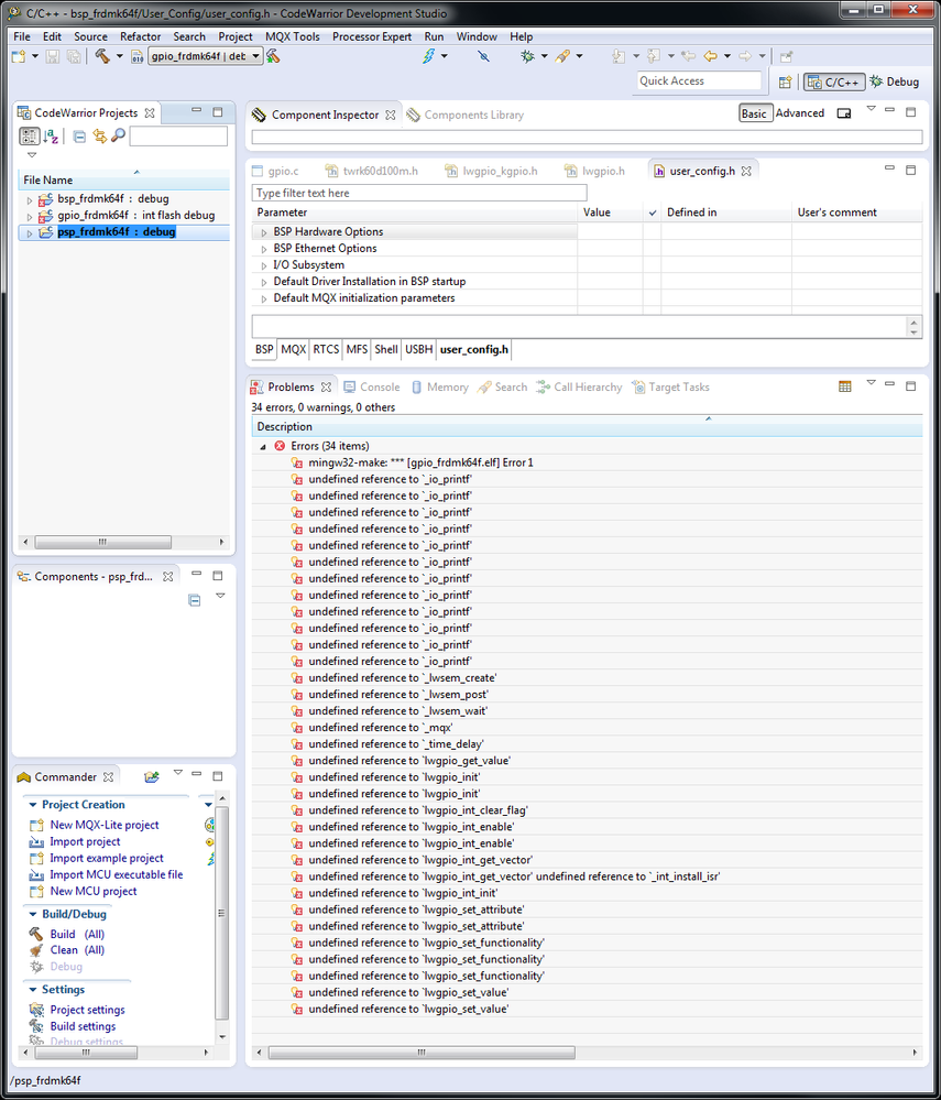

Just wanted to get running an MQX example running on my new FRDM-K64F. But it doesn't matter which example project I try to get running, after drag and droping the .wsd file into the project window and compiling the project, many errors occur. Consecuently I cleaned all and the following error remained:
"mingw32-make: *** No rule to make target `C:/Freescale/Freescale_MQX_4_2/lib/frdmk64f.cw10gcc/debug/psp/psp.a', needed by `gpio_frdmk64f.elf'. Stop."

I also tried to delet the complete folder "frdmk64f.cw10gcc" in C:\Freescale\Freescale_MQX_4_2\lib\... and recompiled it. After compiling the first time I get this
and after I compile a second time i get this
So I still don't know how to get rid of that problem!? :-(

Unfortunately it doesn't matter which I compile first, it always ends up in the same errors. Trying the same with the TWR-K60D100M works properly (well more or less: I had to change in the "Debug Configurations - Debugger - OS Awareness - Target OS:"-Settings from "None" (default) to MQX OS for Cortex).
Below there you can see the console output:
