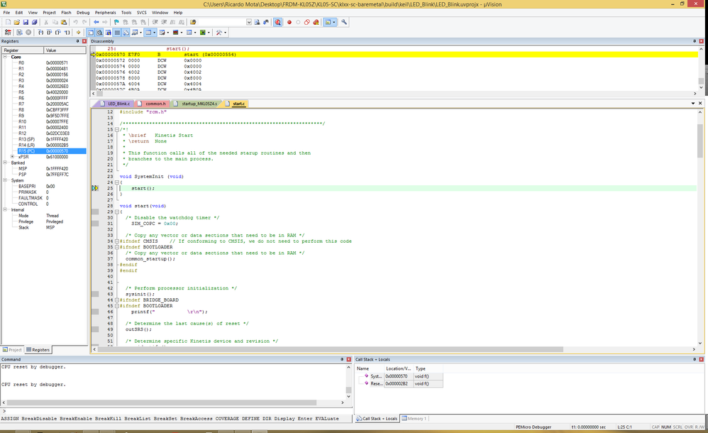

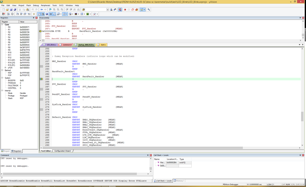

I've bought a FRDM-KL05Z development board and I'm trying to setup the development environment in Keil uVision MDK-ARM v5.15 by trying to run the demo examples included in the FRDM-KL05Z Sample Code Package.
First I've loaded OpenSDA bootloader with PEMicro FRDM-KL05Z Mass Storage/Debug App v1.14 and I'm able to program sucessfully the board from Keil uVision.
However, when i try to debug a simple project like LED_Blink on uVision, I'm unable to run the code, it always halts in the HardFault_Handler at beginning and I can't figure out why.
Can somebody please help me figure out the problem and point me where I can get more information about the reason the program is halting?

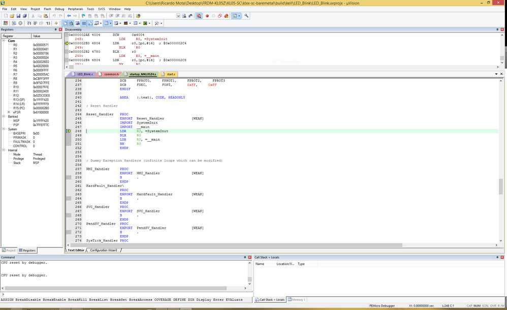

There is not enough information shown to see what the problem is (eg. you haven't shown the register values).

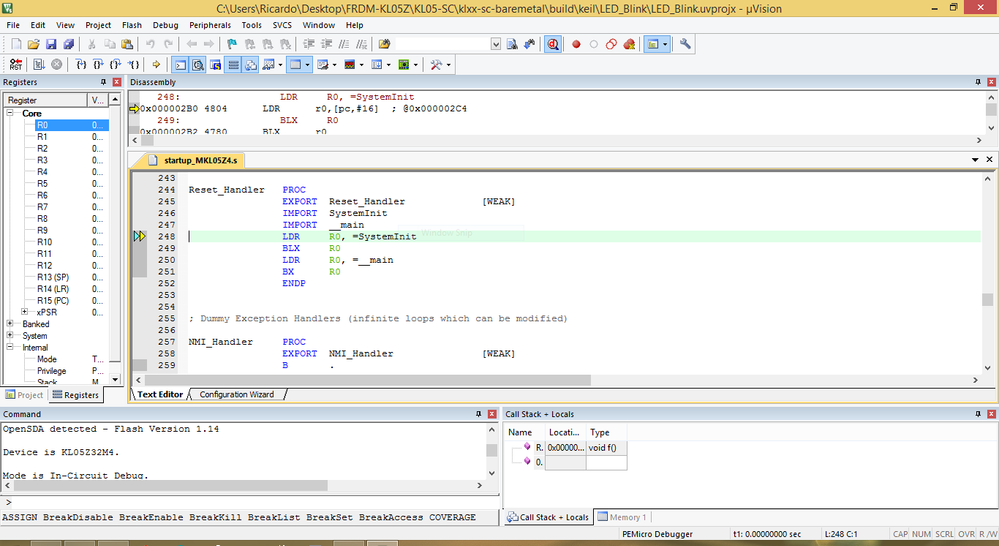

Which registers should I show you to help me figure out the problem?
Are these enough?

Hello Ricardo
All looks correct at that location.
Are you sure that it will crash at this point or does it do so later?

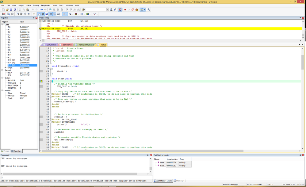

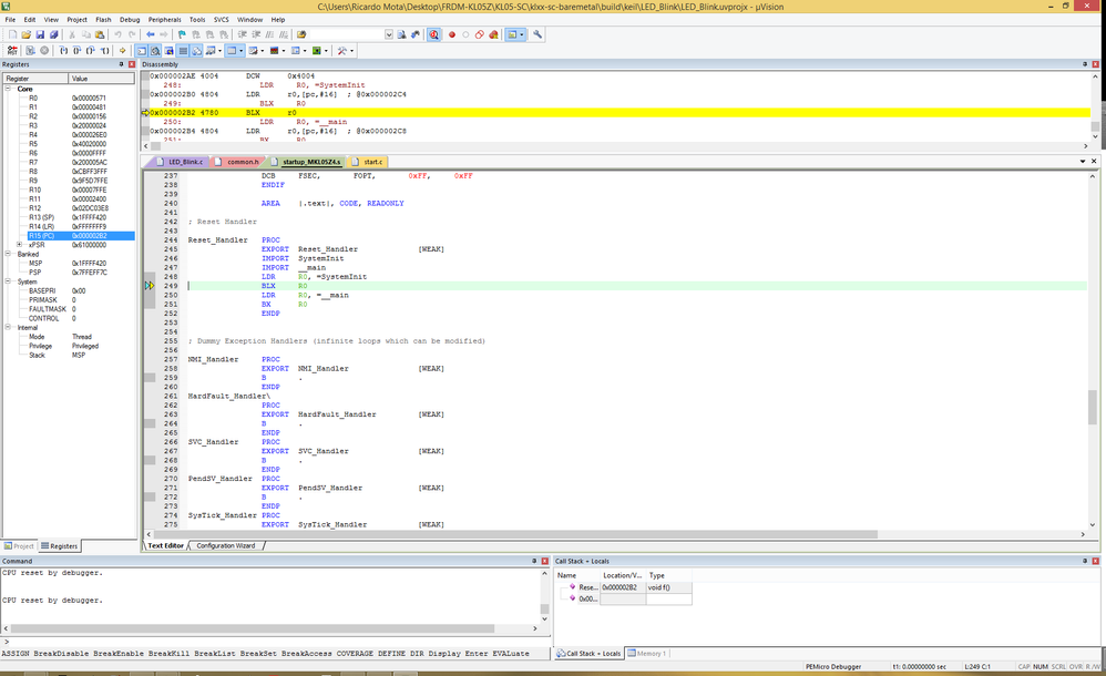

Here are all the steps of execution in sequence, from Reset state until the program halts:

Ricardo
Your stack pointer is set up incorrectly.
It is at 0x1ffff420 but the KL05 (largest version with k RAM) has RAM between 0x1ffffc00 and 0x20000c00.

How can i solve it then?
Since these code examples were downloaded from Freescale's website - FRDM-KL05Z Sample Code Package  - weren't they supposed to run out of the box?! :\

I just downloaded the package and opened the "LED_Blink" project.
It is set up for the KL25 and not the KL05 - if you change the device to suit it's memory map is then correct.

Worked perfectly! Thank you very much for your help and attention mjbcswitzerland​ ! :smileywink:
