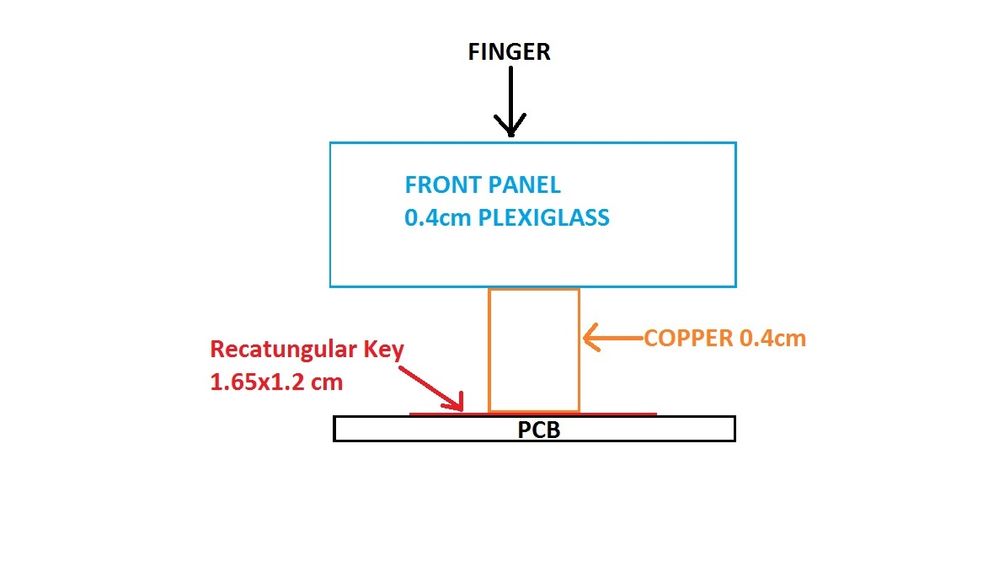

Hi all,
I need the opinion of someone expert with TSI Module and capacitive key.
I have a board with with different devices including a MK20DX256VLK7 cpu and 4 capacitive keys connected to cpu using TSI Module. Key shape is a rectangular about 1.65(b)x1.2(h) cm and they are separated from each other with 0.2cm distance. Above each key is placed a copper tower about 0.4cm in order to reduce non-conducting strate and finally there is a plexiglass front panel about others 0.4cm. The follow figure shows the layout for one key.
The finger's distance is about 0.8cm.

Yes I am using latest TSS library and obviously I read that Application Note.
The PCB is 4 layers:
1) First Layer, Top side with components
2) GND Plane
3) Power Plane and a small GND with the ground for capacitive keys
4) Bottom side, with the 4 capacitive keys
So in the layer next the capacitive keys there is their ground play, made with hatching.
This is an image of the PCB gerber with Red = Layer 4, Blu = Layer 3 with GND hatching
As I said on first post, I am able to sense the touch with some configurations, but not always  with all configurations despite I am using a very close configuration. The touch is sensed in a too much random way.
